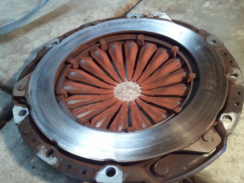

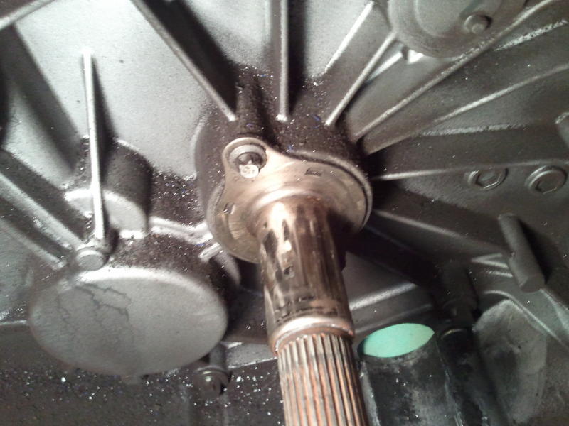

pictures of the clutch
Well, I got it all apart tonight and here are some pictures to show you where the failure was on the clutch fork. A couple of questions too.
How does the clutch look for 65k miles? It's an aftermarket SPEC stage 2.
I plan to buy a new guide bushing, clutch fork, pressure pin, throwout bearing, and clutch.
Do I need to buy a flywheel or get this one resurfaced?
This is my first clutch, how vital is a clutch alignment tool?

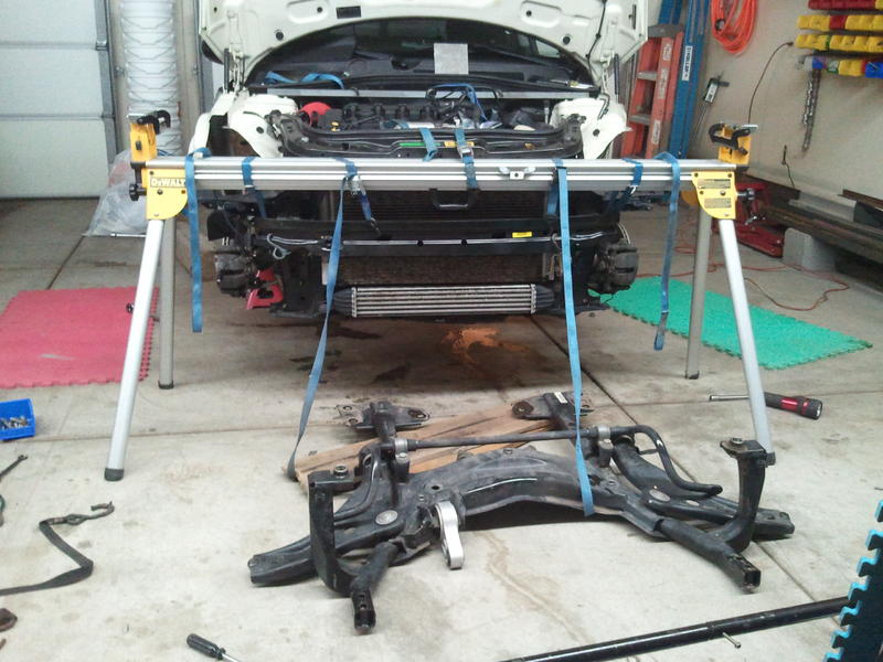

This took me about 7 hours total to get it completely apart including rolling it out of the garage two different times to pressure wash it. This was the first time I've had the mini this much apart. Here are a few more pics of the progress. I like the open wheel look of the last picture, it gives it a cool go-cart feel.
Clutch Alignment tool is vital, some clutch kits come with one but not all, I'm not sure if you have a dual mass Flywheel or not but I hear that DM FW can not be resurfaced,at least on the 1st Gen, I'm not sure. just make sure that when you install the clutch disk that it is facing the correct direction, it should say gear box side or like the one shown in the pic. FW side.
