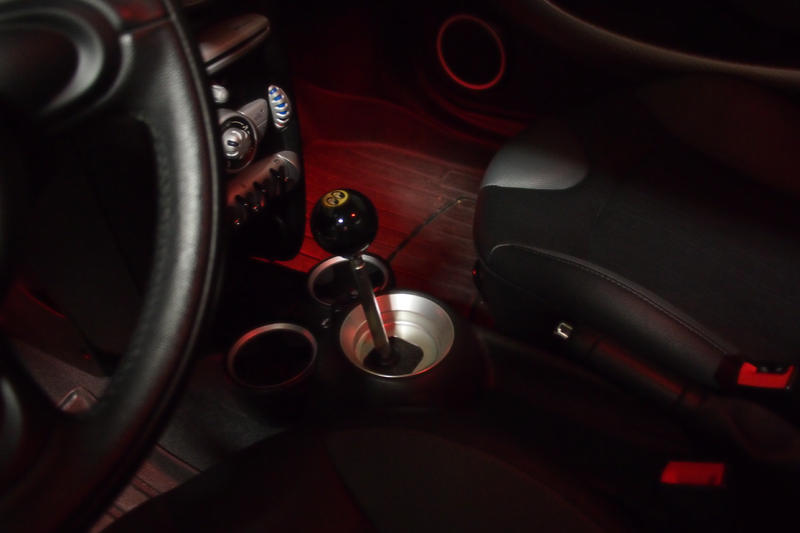

I have a MOON 8 Ball style shift **** on mine. It uses 3 set screws. I also have the CravenSpeed Shift well cover which completes the look.
To use it I had to trim the stock shift lever (I used a hand saw but a dremel type tool would be much quicker since the shift lever is solid, not hollow). I trimmed it down to where the plastic collar is on the shifter to attach the stock shift ****, then I cut the plastic collar off.
Once that was done I enlarged the hole on the shift **** so it would slide over the shift lever. Then just clean everything up and apply thread locker to the set screws on the shift ****.
It takes a lot of time but the results are worth it IMO, feels really nice and since I trimmed down the shift lever it's basically a mild short shifter.

I added a pic of the custom shifter to my gallery if anyone's interested.

Attached Thumbnails Any ideas for having universal threaded shift kn*bs?-p1064179.jpg

I like that! We don't make them in silver anymore, it looks good!
