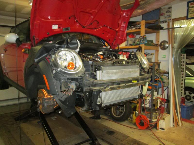

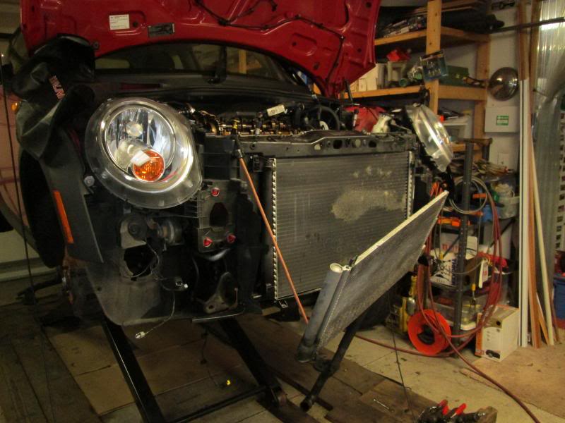

Lowered condenser and removed other parts before removing front support:

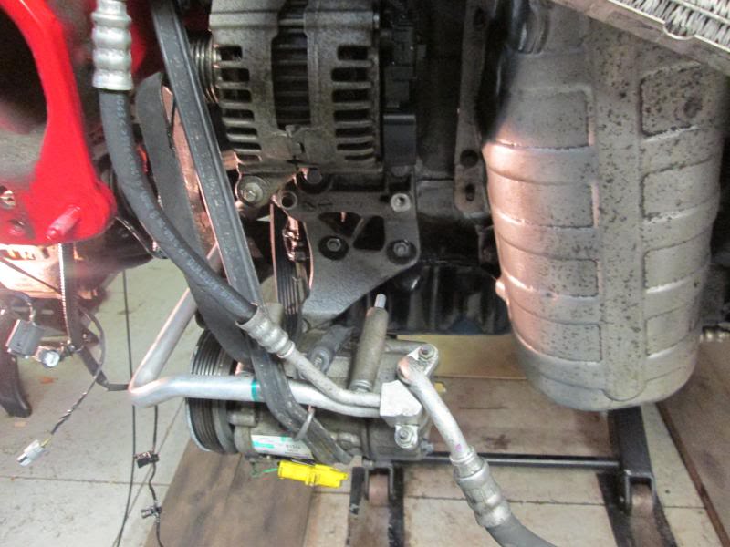

Unbolt A/C compressor and remove serpentine belt:

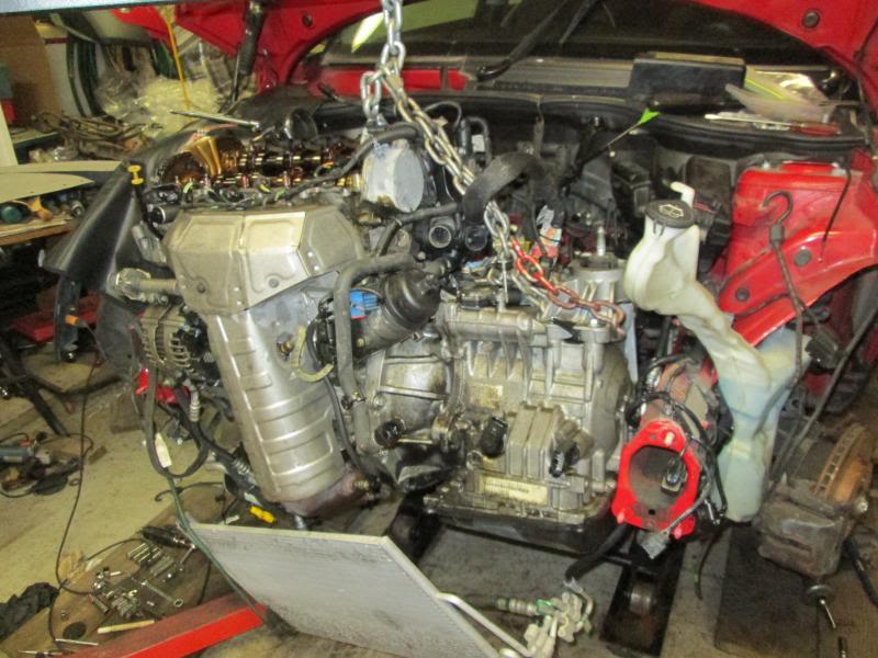

Connect engine hoist:
