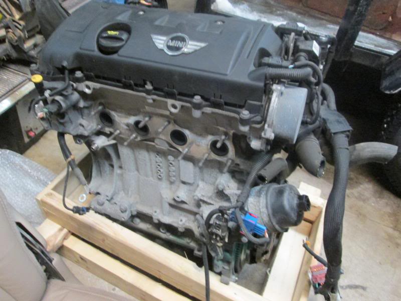

Finally bought a replacement engine for this project.
2010 base motor with 37k miles. Purchased for $2900. I have not yet had a chance to check it over thoroughly, but at first glance it looks good.

Nice engine and for finding a low mileage engine! I noticed that the engine you took out was a dual overhead cam engine, it looks like an N14, so why does the new engine you found different?

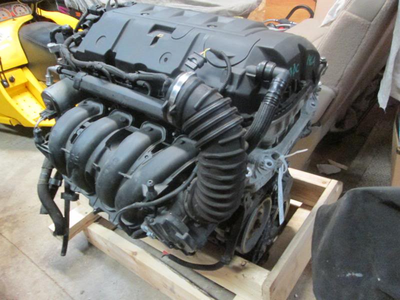

The new engine is the same. Both from base model Mini.

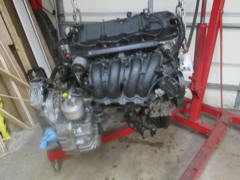

Replacement engine bolted to trans:

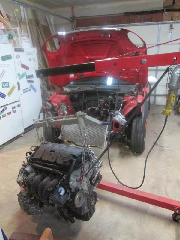

Getting ready to install:
Positioning in the engine compartment:

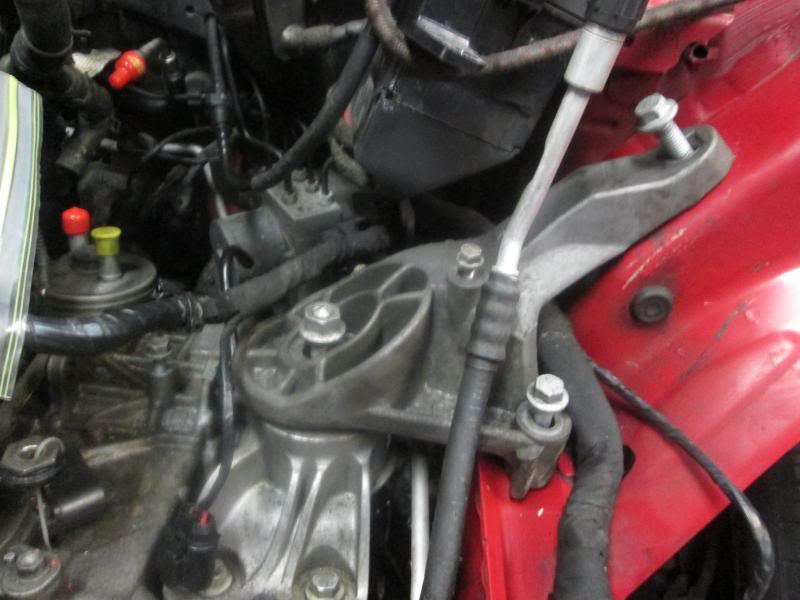

Getting the transmission upper mount attached:

Your remplacement engine looks to be an N18 did you succeed to start it ?
