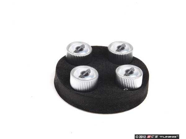

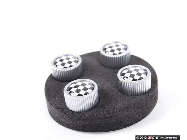

Here are some valve stem caps sets and singles from MINI . There are a couple styles if you are looking to upgrade to match your MINI. Any cap will work. Some guys add a little anti seize with the metal caps.
http://www.ecstuning.com/Mini-2007-Cooper-R56-S-Coupe-L4_1.6L_N14B16A/Wheels/Valve_Stems/Caps/
