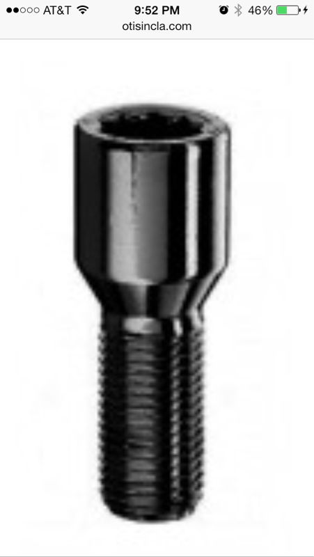

I got my lugs from Otisincla.com They have tuner lugs this size also comes in chrome or black.
Attached Thumbnails Can't find 14x1.5 lug nuts-image-1478647312.jpg   Can't find 14x1.5 lug nuts-image-864281213.jpg

They look exactly like the Discount Tire lugs. You try them?
