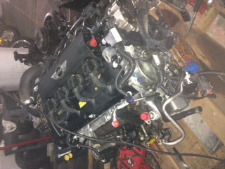

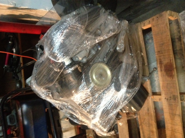

Any tips for a first time engine swap? Planning to get the thing going using all OEM stuff, then start doing some modding from there.
I know I'll need to swap out the MAP sensor from the MCS to the new motor to work.
All I've done so far is dump the fluids from the old engine. The old one is being swapped because it is leaking / burning oil and has a lot of miles (160k). Got a great deal on the minty fresh JCW.

I personally haven't done any engine swaps, but have read and followed many across many platforms. The biggest piece of advice I can give you is to label everything! Label where all the wiring looms go, where the vacuum lines go, where any electrical connections go, etc. This will save some headache down the road when trying to make sure everything is going to work properly.

Provided it's an N14 to an N14 there shouldn't be anything different. The only real differences were internal to the engine (pistons). The rest of the stuff should be the same. I'm not sure if you'll need the ECU or not. Are you swapping just the motor or accessories and everything? You know the JCW turbo is different right?

Done an engine on my dad's Neon one time. Biggest advice is to just look at the job task by little task. It's when you look at the big picture that it can be daunting.
Take lots of pictures as you remove things you are unsure of.
Store all fasteners in ziplock bags with clear understandable labels. Tape fastener bags to part it came from.
Biggest thing is to take your time. If you rush, you WILL screw up.
My biggest question is if the base calibration is different between MCS and JCW. I am more inclined to think so based on the JCW having a lower compression ratio and different turbo.
