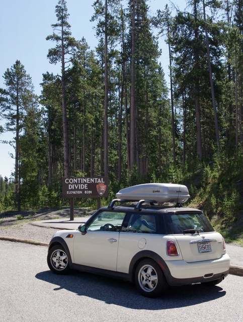

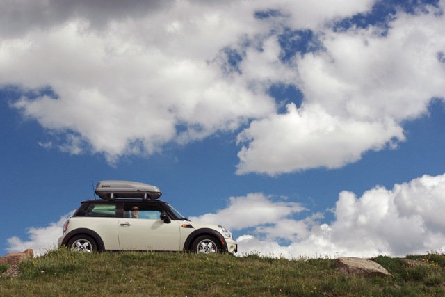

After quite a bit of research, I decided to stick with the MINI brand roof rails (not what you want to hear). The way they attach is a PITA to put them off and on, so I just leave them on. I've always been a big Yakima fan in the past, but the Yakima and Thule racks which rest on the roof sheet metal have too many scary warnings about roof damage.
The current version of MINI brand racks don't touch the sheet metal. Special sockets made just for that purpose are built into the edge of the roof of R56 MINIs. (If yours is another series, then you'll need to investigate.)
I don't own any MINI brand attachments - my bike mounts are Yakima, which I use on the other car. I occasionally use the MINI rack for hauling lumber and canoes, but mostly I got it to expand our capacity to haul camping gear on long road trips. When mounted the crossbars of the MINI rack are about 27" apart, so your basket will need to work with that.
The list price at most MINI dealerships is way too high, but if you shop around they can be had for less than $250. Which is still plenty high, but less than sheet-metal work if your roof gets damaged.
Attached Thumbnails Need some decent price roof racks and baskets-beartooth_hwy-mini.jpg   Need some decent price roof racks and baskets-blue_sky_mini.jpg   Need some decent price roof racks and baskets-divide-mini.jpg
