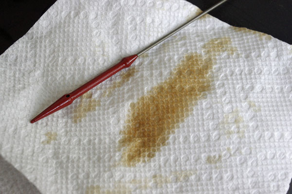

How can I be sure my dealer changed my oil?
My invoice shows my MINI dealer changed my oil and filter as I requested - it's been a year since the last change. Drove it home - about 175 miles. The next morning I checked the level and I was very surprised to see dark blots on the paper towel when I wiped the dipstick. It's a medium-to-dark amber color, not the pale yellow I was expecting.
I have changed the oil myself a couple of times, and I remember the new oil being pretty hard to see for the first few thousand miles. I also remembered that it is almost impossible to change the filter without dribbling some oil down the front of the engine, so I checked there. I expected to find either clean metal, if the mechanic wiped off the spilled oil - or a thin layer of fresh oil if he did not. What I found was dry, black grime that looks like it has not been undisturbed for a long time.
I am fearful that my oil may not have actually been changed - or possibly the oil was changed, but not the filter. Service manager says either is very unlikely.
Q1: Can anybody tell me if they have noticed their new oil getting noticeably darker within the first few hundred miles?
Q2: Would the results of an oil analysis clearly show that my oil has been in use for either 200 miles - or 9,000 miles? (I've never had an oil analysis done.)

I really would be cautious thinking it was changed.. I would think the oil would be nice and clean looking.. By the way you make it sound its not.. When I change my oil it always is very hard to read because its so clean.. It takes weeks before it starts to get a brown tint to it!..lol.. If it was me I would change it again for a peace of mind.
Thanks! Just the kind of reply I was hoping to get - and it backs up my previous experience.
If anybody has a low mileage justa with less than a few hundred miles on a recent oil change I would love to know what your oil looks like on a white paper towel.
I've tried to add a photo to show what I'm talking about.

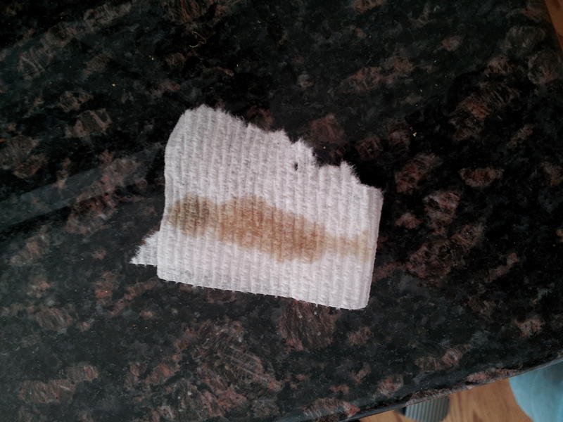

I changed my oil a few days ago and have only put at most 100 miles on it so far, I'll try to grab a picture for you to compare to tomorrow. That doesn't look unusually dark for new oil in my opinion - maybe slightly darker than the honey color of my mobil1 I just put in, but I'll make sure tomorrow.

I'm no expert, but I'm leaning toward thinking that's the original oil. I've done a lot of oil changes over the years, and I feel uncomfortable letting my oils start showing that kind of colour. As others have said, I would change the oil.

Your pic looks completely normal. I changed my oil at 1200 miles and the when I checked the level it looked as dark as the original oil did.
This engine seems to have pockets that hide oil, and it will muck up the color of new oil immediately. If the dealer says they did an oil change they probably did.

Taken 30 minutes ago, the car hasn't been driven today yet.

That is normal looking new oil. Not oil that has 9 or 10k miles on it. You can't get ever last drop of oil out when you change it. The stuff that is left would "dirty" up the new oil a little bit. You should see the oil in my diesel truck after a 1k miles looks like I put black ink in it.

Beautiful - looks just like mine - apparently the new oil colors-up faster than I remembered from previous oil changes. Thanks so much for the photo - which provides valuable evidence that all is well.
