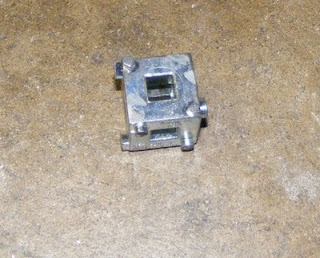

Rear brake caliper piston retracting tool
Hello,
I am getting ready to change the brakes on my 2010 MCS soon and I saw this tool in the "brake parts" section of this website. I was wondering if any of you have changed your own brakes before and needed this tool to complete your installation? Would I just be able to use a "C-Clamp" to push the piston back in? I just want to make sure I have everything I need when I go to change them in a couple weeks.

Assuming Gen2 rear brakes are like Gen1 rears, you need to both rotate and compress the pistons; that is what the 'special' tool does.

Most auto parts store sell this tool and some have a universal square block that attaches to your ratchet for under $10.00 It is not so much about pushing it in as it turns in, so never use a c clamp or you will ruin them.

No you can't just compress the rear piston with a c-clamp. You can use it on the front but the rears require the tool. You'll damage the caliper that way if you succeed at all. The caliper has to twist while its being pressed in. Some people have managed without the tool but its really rough without it. Harbor freight sells the tool for ~$35 or you can use it for free if you "rent" it from a local auto parts store like advance or autozone. They typically have tool rental programs

Looks like this

Thanks everyone! I will definitely use the "special tool" whether I have to buy it or rent it.
