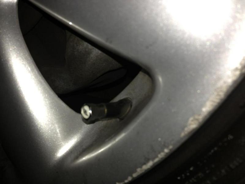

Here is a pic (sorry about the quality) of my Valve stem. As you can see its all rubber, there isn't any metal part to it.
Yes I know the logical thing to do would be to drive it in to the dealer, but as I bought it second hand, they are not overly helpful. Their view is that I didn't buy it from them so there is no obligation to provide ongoing assistance. Doesn't help that I get it serviced by an independent Mechanic :P
Definitely looks like the non sensor version.

While Braminator brings a good point that some rubber ones are available. I doubt MINI would source 2 different suppliers or parts for the same item. There could be some really weird or odd regulations with regards to certain frequencies "down under" but when I see a rubber stem my gut tells me with 99% confidence that the car has rotational or no TPMS.
I agree, I was just showing that you can not just assume since they are rubber that they are not TPMS sensors. I highly doubt he has the rubber sensor style as MINI never used them. But it is possible they could of been replaced to the rubber style.

Thanks so much for all your Input, I'm going take the punt and get the new rims fitted without sensors, it isn't mandatory here in aus like it is for you guys so if it is meant to have sensors and I don't fit them, life goes on.
