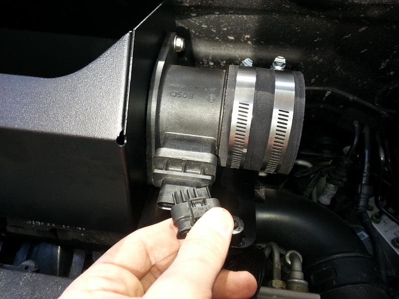

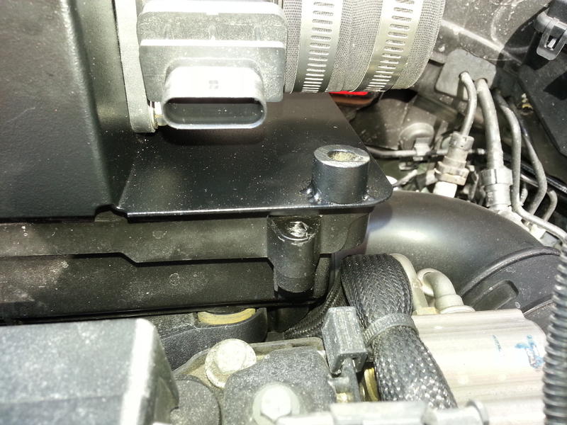

I purchased this intake for my 2010 MCS last weekend and tried to install it yesterday. I ran into two problems, 1) The intake shield/box from K&N did not match up with the mounting holes on the stock intake box and 2) The MAF sensor plug came up short about 1-2 inches from where it should plug in.

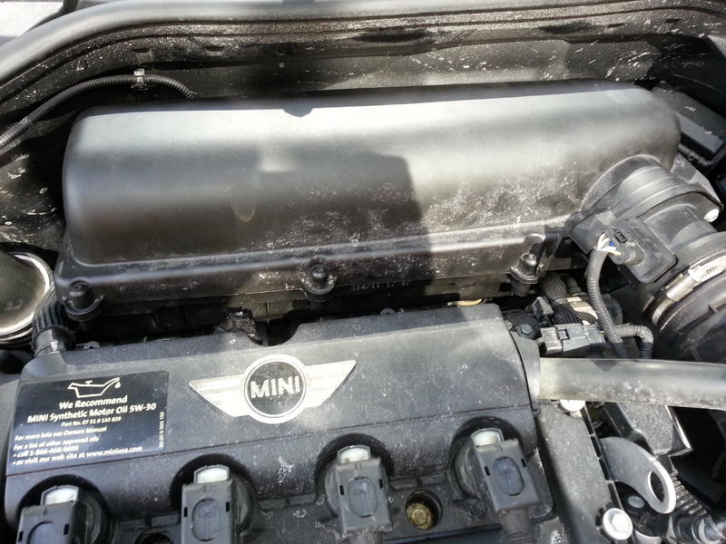

Has anyone else had this problem? The one major difference I noticed was that the top of my air box only has 3 screws while the one shown in the diagrams had 4? If someone aslo has a 2010 MCS can you please let me know how many screws hold the top of your air box down? Below are also some pictures I took that I will email K&N tomorrow.

Bakerbrdz and Agbullet25 you guys are correct. The customer service representative from K&N also told me that some of the later 2010 models came with the 2011 and up air boxes. That's why my air box has 3 torx screws instead of 4. Here is what he said in a return email:
"It appears you actual have the 2011 airbox in your 2010 model (this is the exact reason why we do not have a kit for the 2011 at this time). Unfortunately, this kit will not fit sure to this slight change in the 2011 airbox."
He also told me that they just finished the intake shield/box for 2011+ models and they should be ready in a couple of weeks. He also said he would ship me one as soon as its available, if I want.

Yeah I have a 2010 and the intake fits perfectly on mine, hopefully you get the new intake shield and all is well. You will love the sound when you get it installed

Sorry its been a while since I gave you guys some feedback/information on this problem. I talked the the customer service representative at K&N again and he told me that the new heat shield/box would fit on my stock air box and he would ship it out immediately BUT he had no solution to the MAF sensor coming up short. I decided to return the intake because I did not feel comfortable lengthen the wiring harness. Besides, it's still under warranty until the end of October and I do not want to risk anything.
Anyway, I have started to look again for another intake and the only one I feel 100% comfortable with is the ALTA one. Only because it's made to fit 2007 - 2010 and 2011+. I have also seen some pictures online and it seems like the wiring harness for the MAF sensor pretty much stays in its stock location. I know some of you have mentioned the DOS BUT I do not want to cut into anything because it is still under warranty. If any of you have an ALTA intake can you let me know how you like it/and if you had any installation problems? I have read some reviews in the products/manufacturers section and they seem pretty mixed. Thanks for your time!
