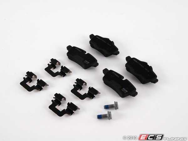

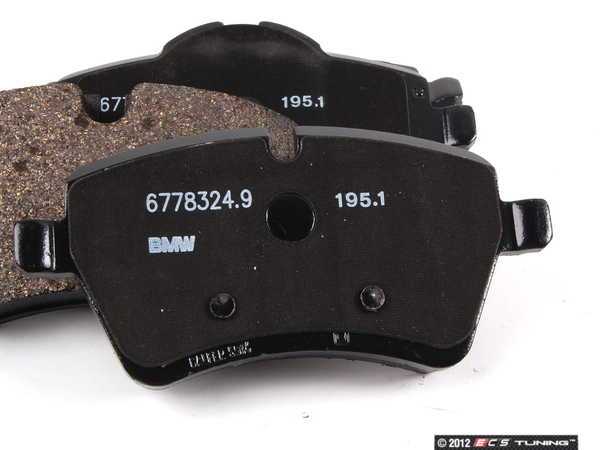

Front pads should look like this:
-8/2010 MINI Cooper S fronts.
http://www.ecstuning.com/Search/34116778320/ES59944/
-8/2010 MINI Cooper S Rears.
http://www.ecstuning.com/Search/34216778327/ES60494/
They should have the BMW or MINI stamping on the back of the pad plate. That will tell you if they were OEM Genuine MINI from the factory.
Anything else and there aftermarket. Hope that helps.

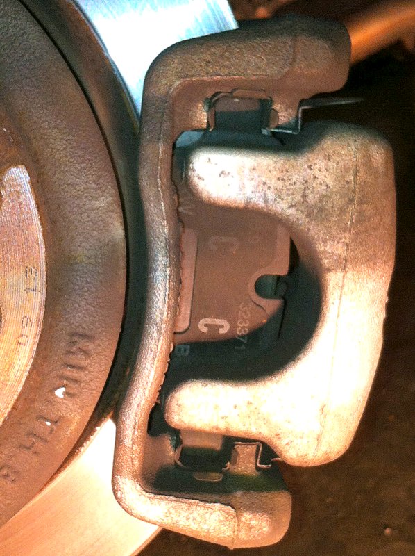

Here is the rear pad.
I didn't get photo of the fronts. I do recall in the center of the pad a cooper color round section. The part number was etched on the side of the pad.

The rears look like the stock pads above, MINI/ BMW change the pad printing over time , but its mostly the same. Once you get a pic of the fronts we will know.
Thanks for the rear pic. That helps a bunch.
The aftermarket ones tend to dust less like Hawk brands. Pics for reference:
http://www.ecstuning.com/Mini-2010-C.../Braking/Pads/
Fronts:
http://www.ecstuning.com/Search/HB560/
Rears:
http://www.ecstuning.com/Mini-2010-C...Braking/Pads/2
Hawk HPS
http://www.ecstuning.com/Search/HB574/
That's what aftermarkets will look like. Its obvious when them come in different colors like EBC Red, Yellow, and Green & Hawk Blue .
Thanks and waiting for more pics.

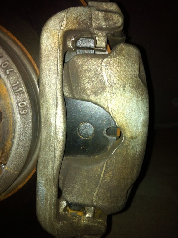

Here is the front. I can't see any markings other than very small laste etched PN or something. too small to read on side of the pad.

From the picture it looks like a stock OE replacement. Has the black plate but no writing, on most aftermarket and Genuine MINI pads they have a marking around or on the shim plate which sits on the back. Can you make out what the writing says , I can see anything in the picture, or it you can get a pic of the pads from another angle. I might not be seeing everything do to the flash.
Thanks for the pics as they do help narrow it down.
