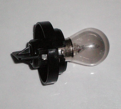

I just popped open the access panel to the tail lights on my 07-S stuck my hand it and pulled 3 different bulbs. The access is tight but I managed to get my hand in.
On the 7 the bulb is just in a sort of backing plug - the electrics are in the assembly - you just twist the bulb 'plug' and out she pops. One even has a set of 'handles' for lack of a better term.

Thank you for the quick response. Mine looks like that from the back. The holder seems stuck and probably just needs a bit more elbow grease to break it loose. I was afraid I was going to break it if I went any further without some insight. Thanks for verification before I proceeded.
