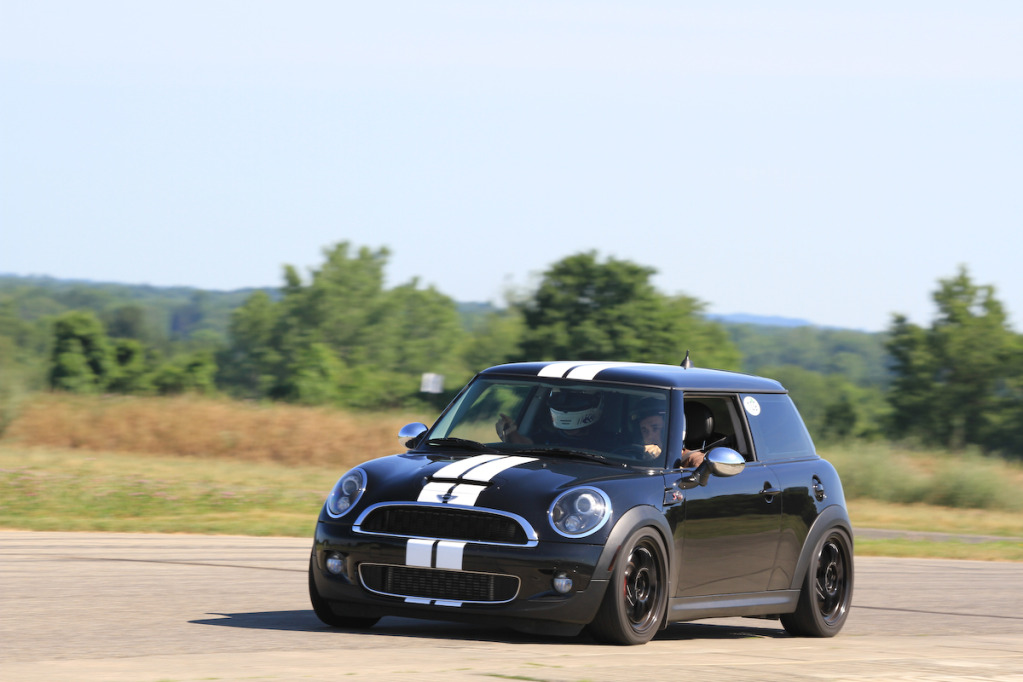

Mine is lowered over 2.5" and I would say it's right at the limit of being too low for track. On 215/45/R17 tires running 17x7 wheels at +43mm offset in the front (+10mm spacer) the front tires definitely will rub a bit when the suspension gets loaded after coming over a hill really fast. It's not to the point of rubbing on metal though. I have a gash in my front wheel well liners and just a hair of the plastic had to be shaved with a Dremel tool. But man does it look good
My rear doesn't rub at all, but that's most likely because I don't need to run a spacer in the back. The only reason I need to have spacers in the front is so the inside of my tire doesn't rub the coilover spring and I also need to clear my big brake calipers.
Here is what it looks like. There is just a little bit of suspension loading on the drivers side since I'm tracking out of a turn. It's still very tucked looking standing along in a parking space.
The lower you make the MINI the larger small objects and animals in the road start to become. BEWARE
It's definitely possible to go lower, but I can say without doubt that driveability will be affected after that. Sure, a car slammed on airbags looks insane, but there is no way a car like that gets driven hard. It's a balancing act.

Originally Posted by countryboyshane
If you want to be JCW Challenge low, you need coilovers. That's all there is to it. I believe they used to run a modified KW V3. Not sure what kind now. Even on lowering springs you'll have plenty of wheel gap. By plenty I mean about two-three fingers. Certainly better than a fistful like stock. There are plenty of pictures of users with lowering springs on this discussion:
https://www.northamericanmotoring.co...ered-mini.html
Dear Shane. You stopped my heart. It's true love lol. Extremely nice.
