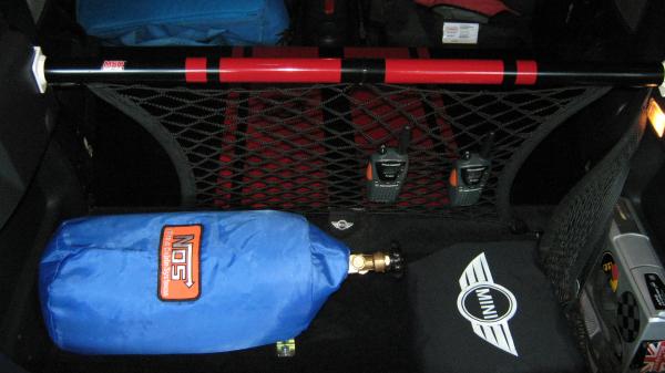

Installing the rear upper stress bar reducing body flex also had a degree of benefit...
