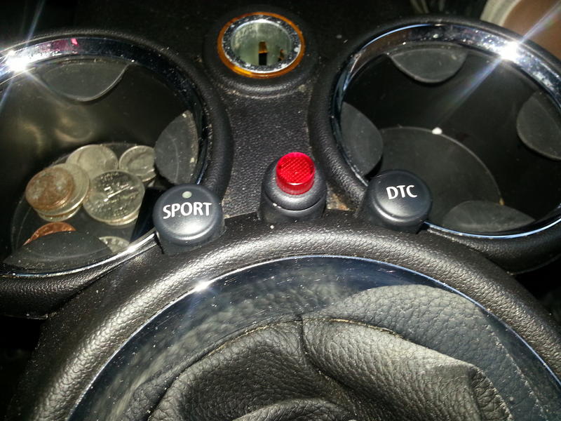

Well I guys I finally got it. It has two dog ear clips on the side of the clip. I finally took the back of the console where the parking brake is. Which by the way was a lot easier to get out than I had thought. But once I had that off i could get to it and it came right off. I hard wired my radar in but I wanted to a way to turn it off just in case I was getting a ticket. But here is the picture it works great by the way. I know it looks dirty but i took this right after I got it together. thanks for the help guys or at the very least the encouragement.

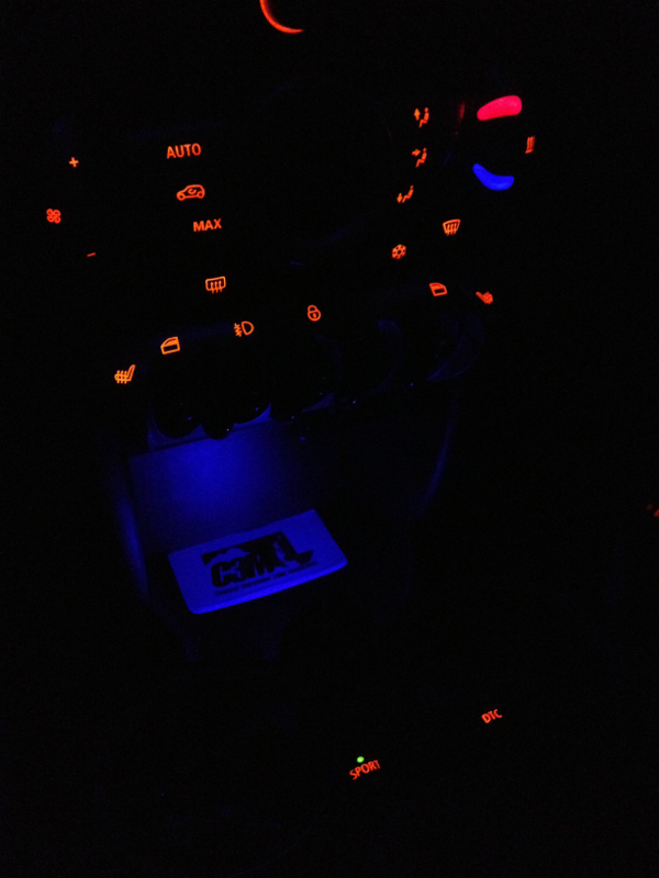

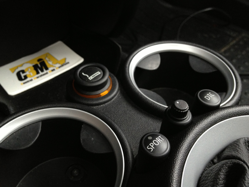

On mine, wiring was long enough to work the console out of the shifter and hand brake & flip it over. From there it was easy to release the clips.
I put the subwoofer control **** on top of the middle button & wired the led indicator to shine on the small storage
Attached Thumbnails Help with center console where the shifter is.-image-1875218829.jpg   Help with center console where the shifter is.-image-1159048841.jpg

I have a Bass600 in the boot, it came with a remote level control with a bright led indicator. I disassembled it and noticed that it was just the right size to fit in button. I extended the wiring for the led & drilled a hole in front of the cig plug.
I don't consider myself skilled either, I'd say anyone can do it.
