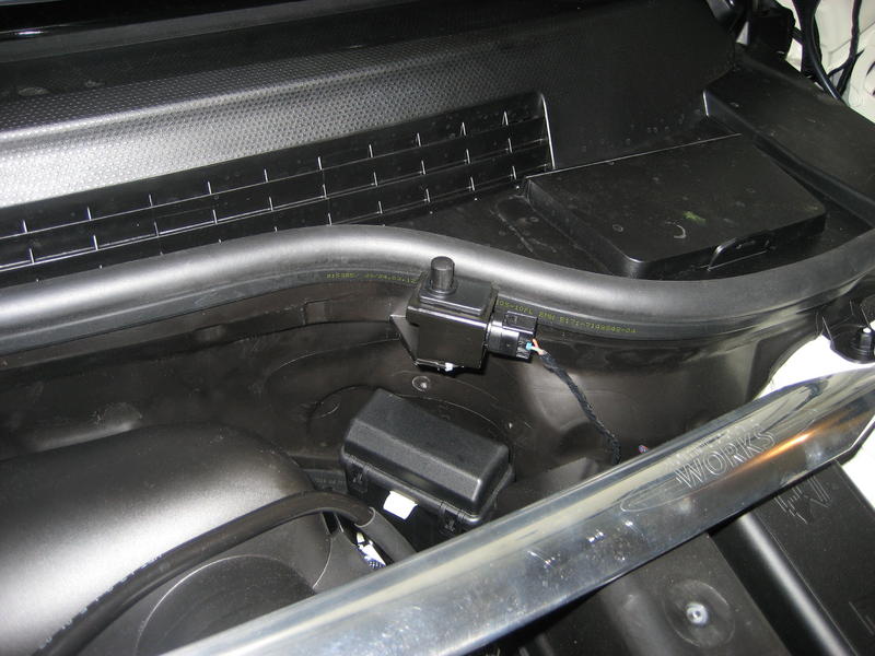

need help with my MCS 2012
Regarding the mounting...where did you guys move that button/sense that senses the hood close????..it seems to be on the bracket where you would mount the catch can.
Attached Thumbnails Oil catch can questions-img_1973.jpg   Oil catch can questions-img_1975.jpg

My 07 didn't have that button, only the bracket. What is the button?
Old May 13, 2012 | 01:42 PM
jimb73's Avatar
jimb73
Joined: Feb 2012
Posts: 13
I don't really know....I was hoping someone would explain the install a bit for this
Pretty sure it's part of the security system.
I mounted my OCC just to the left of the bracket, next to the JCW CAI box, it was a snug fit but it works well.

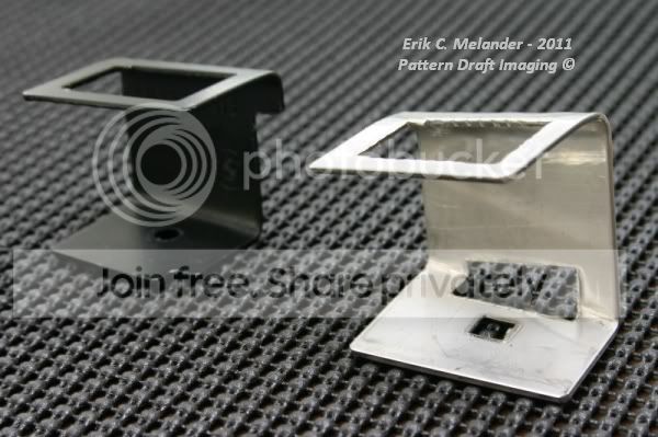

Didn't relocate button; but did make new bracket:
- Erik

Ok...thanks....Blue fox, that looks great.
