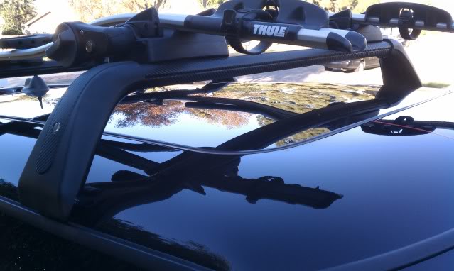

I've owned door sill mounted racks in the past, however I'd go with the OEM system hands down! Custom-fit into the rain gutter (doesn't touch the roof) and it's easy to mount a variety of accessories to it (Thule Criterium bike trays in the pic).
+++ for the OEM, you can see how they mount here!
BTW love the wrap on the silver rails, does it go inside the rail too? How does it hold up to the sliding racks? Thanks!
Nice Rack!! Love it! What did you do to black out all the components? Explain please!
He has a thread about it somewhere but I can't seem to find it. Pretty sure he used 3M carbon vinyl to wrap everything. I know it's wrapped, just can't remember the brand. It looks great all black. If I had a black car I'd do the same thing. But my roof is silver so the silver on the bars actually matches great...

Here's the link to my vinyl wrapping. It's 3M black carbon Scotchprint 1080 (different than 3M Di-noc.) It's an amazingly durable material. Almost impossible to scratch or tear and has a long outdoor life span. I coat all my plastic and vinyl with 303 Aerospace protectant or Sonus Total Eclipse (spf 40) to keep them from fading. I do this about once a month.
https://www.northamericanmotoring.co...inyl-pics.html
You can see that I wrapped the vinyl to the inside a few inches. To mount my bike trays, I use the Thule Xadapt kit (bolts that slide into the channel). I wanted to keep the factory rubber channel strip so I drilled small holes in them for the Xadapt bolts to come up through. It came out very clean.
