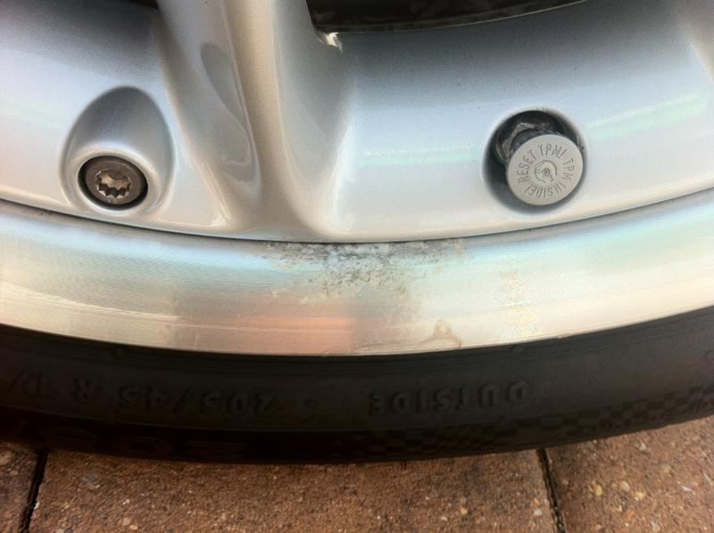

I have corrosion on 3 of my 2009 S' 17" web spoke alloy wheels.
It's going into the dealer next week but they are already giving me the "This won't be covered under warranty unless you bought the road hazard guarantee" story.
The car was purchased in Oct 09, has 16k miles and is rarely driven in winter.
Anyone have any advice, tips, etc.
Attached Thumbnails Corrosion on 17" web spoke wheels?-mini1.jpg   Corrosion on 17" web spoke wheels?-mini2.jpg

Unfortunately i will have to say one of the pictures looks way to much like curb rash to be covered. the other one close to the inner spokes that should be covered.
But with that said the one that looks like curb rash seems to show there is some kind of painted layer or some thing on it. Mine are not like that they are polished stainless and did not look like that when rock rashed one time.

There are many more spots. None in locations where it could be curb rash.
When you see it up close you can see it's almost like there is a thick, clear plastic covering the wheel that looks like its peeling away, then the area under it is corroding.

blowing up the curb rash one. you are right it looks as if there is some sort of clear coat or something that is pealing.
You may be able to push it with the ones that are not curb rashed. as they should be covered. under warranty. i know a few people who have had their web spokes redone under warranty for the spokes getting corroded if the paint chipped.
If there is another dealer close by then maybe head over there and see if they will do anything for you. If not push your dealer when you arrive and pressure them to give you a fantastic reason why it should not be covered. just remember to stay calm.

If these wheels are made by BBS then its very possible its the clear coat corroding and peeling off. The MKIV Jetta with the 16inch BBS two-peice wheels had terrible issues it this and even today if you have a set that is corroding VW will replace them under warranty.

when you washed your mini, did you used any type of 'wheel cleaner'? they're quite harsh on the wheels and can visually cause problems. that's y i never use them.
Bingo, this is correct.
With the R98 webspokes, you can separate the wheel barrel and the wheel face and easily strip off the clear coat on the barrel and re-polish at home. If you don't want to tackle a refinishing project yourself, I would keep contacting the dealer and showing him other instances as others have gotten "wheel warranty" due to faulty / poor clear coat.
Interested. How do you easily strip off the clear coat? After re-polishing, do you clear coat again?
Old Jul 11, 2012 | 01:17 PM
bluefox280's Avatar
bluefox280
Joined: Nov 2009
Posts: 2,120
Likes: 17
From: Broomfield, CO
Pretty simply once you remove the wheel face from the barrell.
You'll use some aircraft stripper solvent to remove the clear coat.
No, simply polish the metal to a good shine and leave it bare.
You can wax it to fill any micro-pours in the metal.
What's great is that if rescratched, or losses shine, simply repolish with your favorite metal polishing compound.
- Erik
