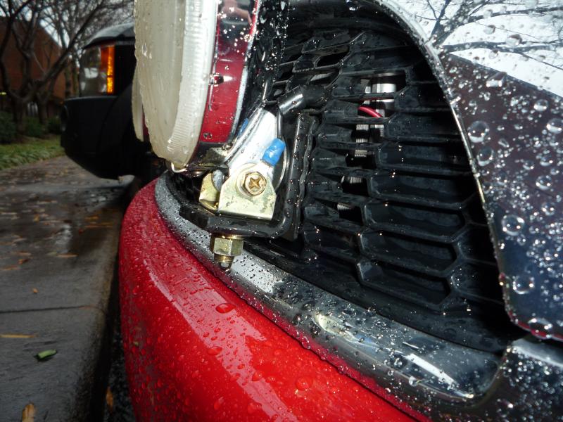

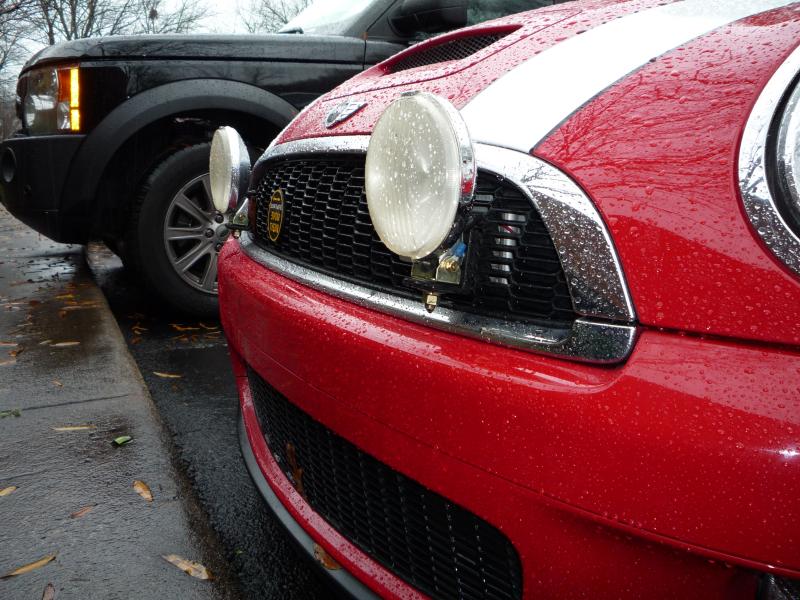

Angle brackets bolted through with fender washers behind (see the photos). No cutting, and they are much more secure than the factory brackets (and way cheaper). My dealer won't put Minis with factory DL's through their car wash because they get damaged. Mine goes through it just fine.

With the lights (they're not Hellas), the whole thing cost about $60. See my posts in this thread for details on materials, cost and assembly:
https://www.northamericanmotoring.co...ml#post2585942

Rubber Strips:
8990K13
Weather-Resistant EPDM Rubber Strip Plain Black,
3/32" Thk, 2" W, 36" L, Black
In Stock at $3.18 Each
I don't have photos behind the grill. Fender washers are just flat washers that are very large around on the outside but have a small hole in the center like a standard washer. You can get them in the specialty hardware drawers at Home Depot. These go behind the slats in the grill and act like a clamp against the back side of the grill. I'm pretty sure there's another thread (maybe in the Gen 1 electrical forum) that has behind the grill photos.

Ok, i think i get it now , so from the front its just the bracket then the rubber strip ........then from the back there is one fender washer like this>
with a long bolt that screw from the top of the fender washer to the bracket hole....and you just screw the driving lights in to the bottom hole of the bracket?
Do you know if the HELLA's will fit in the hole on the bracket?(the brackets are the short kind not the long right?)

You got it.
The Hellas are real shallow so they'll fit no problem. The brackets have a long side and a short side and you can mount them either way. I wanted mine as close to the grill as possible so I have the short side sticking out.

The mounts look good. Bigger fender washers will have bigger holes but you can just put them underneath the ones you've already installed. You'll be amazed at how strong the grill is and how well it supports the lights. Much stronger than the factory brackets.

I don't have any torque specs. Just put a lock washer underneath the nuts and snug them down until the brackets don't move. You obviously don't want to over-tighten and crack the plastic, but it's pretty tough stuff.
