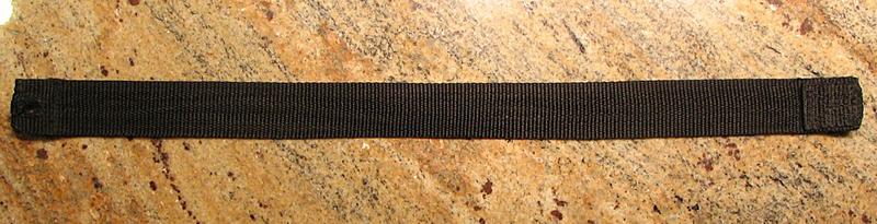

Tired of reaching for those back seats to pull them up? I was. And I didn't want to pay $20-30 for a simple strap so I made them on my own. It was cheap and easy and looks like the ones they sell online. Here's how it goes:
1. Find a strap. I used an old backpack strap ( i also conisdered using a strap off my tennis racket bag holder)
2. Cut the strap to make two. Both should have one good end that was the actual end of the strap and the cut end.
3. Drill a hole in the cut end, big enough to fit around the seat headrest post. I burned off the frayed pieces of string with a lighter.
4. place a velcro button on the opposite end ( I had an old velcro kit laying around the house and then glued it on to the strap)
5. Put it on the outside post on the seat headrest and your done! See pics below. Works great. Hope this helps, for those who need to constantly use the back seat for hauling, it sures helps me and was the easiest mod ever!
