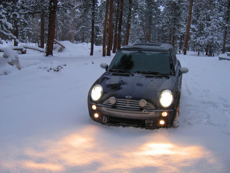

Snow is fun!
Attached Thumbnails Buried in Snow..need help from justaminis!-img_3224.jpg   Buried in Snow..need help from justaminis!-img_3228.jpg
