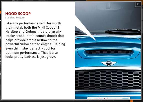

Old Jan 13, 2008 | 06:08 PM
n1tr0's Avatar
n1tr0
Joined: Oct 2007
Posts: 1,025
From: WA
just surfing the miniusa website again, the "functional air scoop" is still/again listed as a standard feature. .... right
"...helps provide ample airflow to the powerful turbocharged motor..."
I'll likely be adding an M7 ags-r intake to my mini as my budget allows, partly for the performance and partly to avoid the embarrassment of having a fake hoodscoop on my hotrod
Attached Thumbnails Now that R56 is a year old, any real call for a functional scoop?-functional_scoop.jpg
