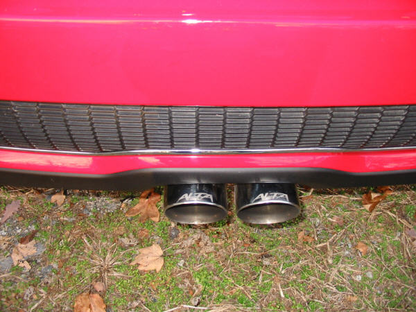

Li'l Red is now a baritone instead of a tenor! Installed the turbo-back last nite, sounds good! Idle is quiet but throaty, cruise is quiet, but crack the throttle, and he sings! Only objection is some resonance somewhere around 3k. The butt dyno shows a marked improvement in torque. Took 5 hours to install, but I was not in a hurry. It was kinda fun!

Over all, the installation went smoothly except for the heat shields, this is where I spent the overwhelming majority of time. If I did it again, it would be quicker and easier.
