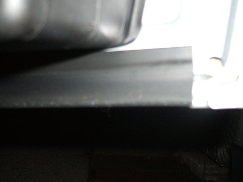

I posted this on the Clubman forum.
The Clubman has a bottom door seal on the right door/club door, but no seal on the left. I had my service manager look into it and she e-mailed a picture of the service bulletin for the R56.
The Service Bulletin is from August-2007 and was written for the R56.
Isn't the R55 US driver's side door the same as the R56?
Here's the text, since I can't figure out how to post the bulletin picture sent from the Mini parts manager:
Mini DelaerNet
TIS-Technical Information System
Subject: Lower Door Seal Deleted
Model: R56(Cooper and Cooper S) produced from 8/2007
The lower door seal, which runs the length of the left and right doors is located directly below each door panel, has been eliminated on cars produced from 8/2007.
Eliminating this seal does not have any negative effects on body sealing.
As these vehicles were not equipped with these parts from production, no warranty reimbursement will be made to retrofit these seals to later vehicles.
--end of service bulletin
So, it appears that the US Clubman passenger side door contains a seal, due to the club door.
The driver's side door does not contain a seal. You may still purchase the seal, as my dealer offered.

I went out and snapped some pics. I can verify that Dragonwagon is correct. The first pic is the passenger side door (with weather strip), second pic is club door (with weather strip) and third pic is drivers side without weather strip. I will talk to my SA on Friday and see what he says. I don't know why they would not have it on the driver's side.
Also, please excuse the poor quality of the pics. I just ran out there barefoot and snapped away.
Attached Thumbnails Bottom door seal-random-001.jpg   Bottom door seal-random-002.jpg   Bottom door seal-random-003.jpg
