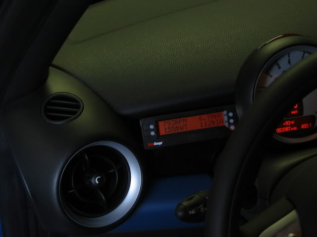

Installed mine today. Easy. Seems to work good, didn't have time to drive around any due to the game tonight.
Here's some pictures:
