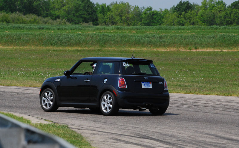

On Monday I had my first opportunity to bring Astro, my R56 MCS to Gingerman Raceway. I've always liked Gingerman for it's interesting combination of corner styles, lots of run-off area, and beautiful farmland setting in western Michigan. I've had my R53 there several times, in "pretty much stock" trim to "lots of bolt ons" to "turbo-only w/ R-compound tires". This was the first time I've had my R56 on the track, and really the first time I've pushed the car to its limits.

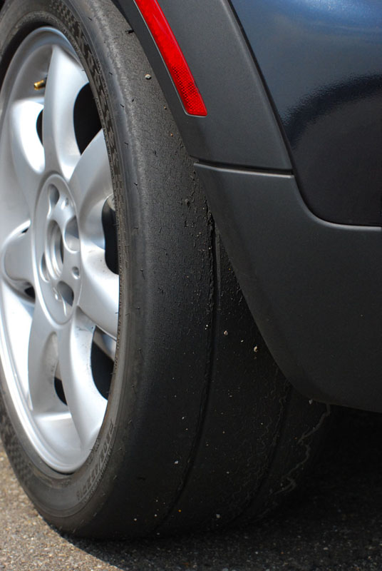

*Hoosier RS304's in 205/45-16 on stock bridge spokes

The first few sessions I was learning the track again. This was the first time I've run the Hoosiers, and while they did take a full 2 laps to get up to temperature, they do offer unbelievable grip!
The first thing I noticed with the R56 was how neutral, balanced, and adjustable it was in the corners. No matter the corner style; sharp 90 degree, full throttle sweeper, off camber double apex, the car was always neutral and very confident feeling. If I came into the corner too hot, a tiny bit of throttle reduction would rotate the car back into the desired line and then it was pedal down to the floor, the LSD would pull the car through the rest of the corner to my exit spot. I'm truly impressed with the balance of the R56. With the standard suspension and the H&R springs, the car has essentially no understeer or oversteer. Of course you can induce either, which makes mid corner correction so easy. Through the corners, it was very easy for me to be quicker than the R53s due to the awesome neutrality and adjustability. All that said, the car has some massive body roll compared to the R53's, WOW! That body roll however is attributed to stock puny swaybars and the H&R springs which are basically the stock rates.

--->lava: Actually I have 18's for the street. I only ran my 16's because I had a set of 16" Hoosiers laying around and decided to mount them on the stock 16" wheels. There is definitely a benefit to lower profile, but being the Hoosiers were 205/45-16, their profile is already short, and their overall height being 1" shorter than stock helped the gearing and Cg immensely too! You can't get an 18" tire that's only 23.2" tall. With my R53, I ran 225/40-18's on the track, but I had to carve out my wheelwells to do it.

--->Klasse Act: Yes, the car handles much better on race tires than on street tires!

Nice write up and pics Ryan. Gingerman looks like a killer track.
