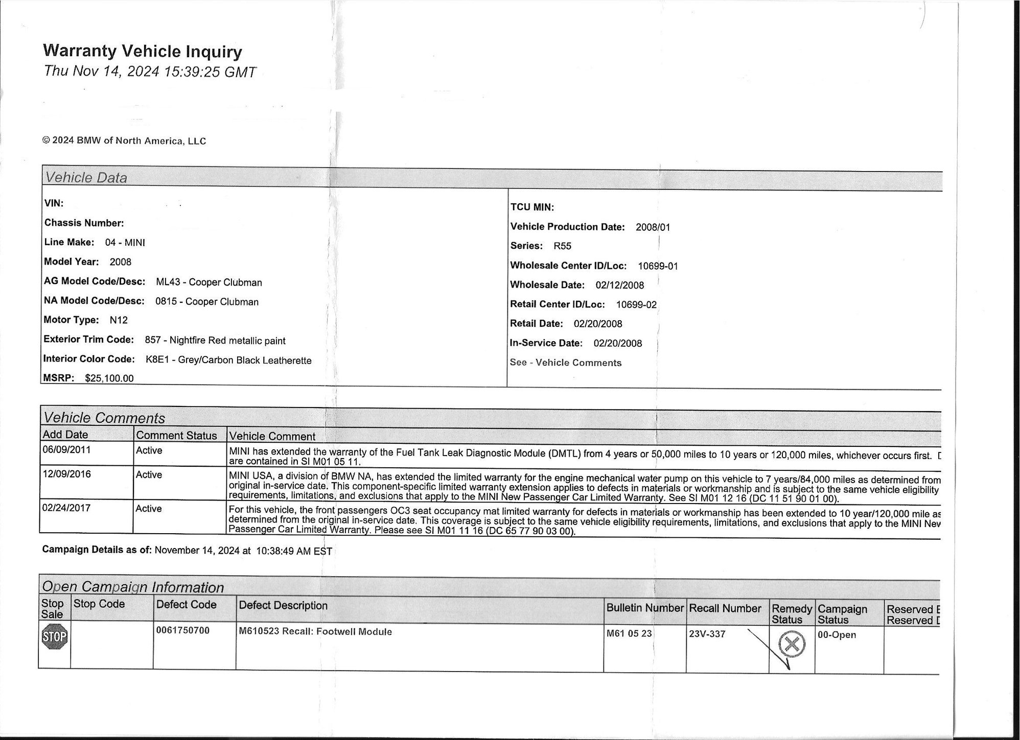

I also received a letter from Mini corporate back in August, It said remedy was available. This has not been accurate. It is now November and the remedy is still unavailable. I contacted corporate and they have no answers as to when it will be available. I also contacted NHTSA, with no resolution.
Since you were lucky enough to get this done, can you share any details regarding what they did? Clean the contacts? Replaced the FRM? Did they do any damage to the headliner checking the drains? Did it do any good having it done?
Thanks in advance for your kind reply.
Rob

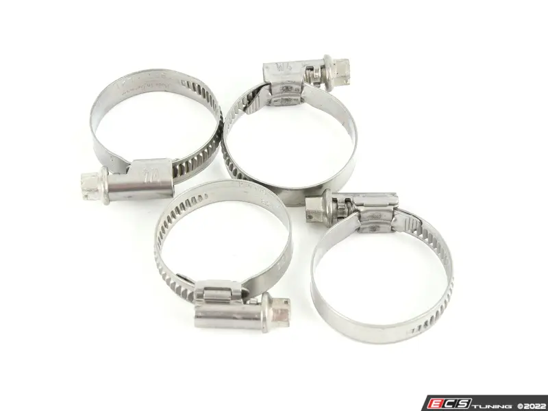

They had the car for 3 days and told me they had to first open take the headliner down check draintube and floor carpet to assess if there's any water accumulation and signs of water entering the module on the left front side
near the hood latch. They said the tube was clogged but no water damage as the car was parked in the garage. As for the module, they simply put a piece of clear semi rigid film to cover a strategic area to allow water to run pass
it, that's the fix. I would assume if they see sign/s of water entry / rust near the module, they would probably replace it. I took a picture of the "fix" haha and will share again.

They are using hose clamps also just like my kit i made a while back.
https://www.ecstuning.com/Search/Sit...h/51738197504/
Thats the film: https://www.ecstuning.com/b-genuine-...m/61139432615/

Something else that I saw on the dealer paperwork was that there is a "no sale" flag on my car/VIN, due to the recall not being addressed. So not only it isn't going to get repaired under the recall, i guess that I am not able to trade it either? It would be interesting to know what type of response you get from Corporate???
