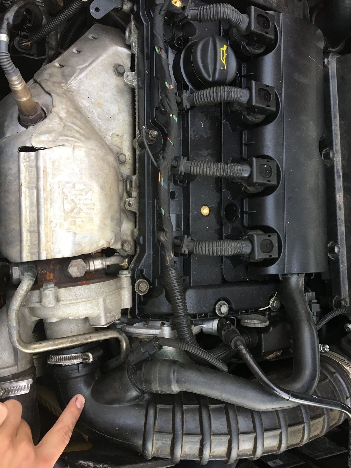

to get it to auto parts stores and no codes came up I don't know much about these many coopers but I found a hose that had come loose it's the big hose on top of the engine and I'll need to replace it. it didn't just come loose but it seems to have dry rotted and broken I will show you a picture of what I'm talking about I need to find out what house it is

Hose
this is the hose and at this connection is where it broke off

Old Nov 22, 2016 | 01:46 PM
MiniToBe's Avatar
MiniToBe
Joined: Jan 2015
Posts: 4,339
Likes: 437
From: Philadelphia PA
Yep that's your intake pipe. Air is leaking in and the MAF isnt recording that extra air. Try to seal it or replace it.

Would that cause a short loss of power and then some rough idling?
Old Nov 22, 2016 | 02:37 PM
nkfry's Avatar
nkfry
Vendor - Detroit Tuned 15 Years
Joined: Jul 2014
Posts: 1,859
Likes: 34
From: Clawson, MI
Unmetered air can cause a slew of problems and yes, loss of power and rough idle are of those problems.

I see a couple of other things that need attention in that picture besides the broken air hose. Firstly, the small hose that comes off your broken one attaches to the valve cover. This is a PCV hose and the clip that holds it securely in place is missing. This could also be a source of unmetered intake air so it should be secured. The part looks like this;
https://www.ecstuning.com/b-genuine-...h/13717570673/
The other end of that small hose should have a ty-wrap to hold it secure as well. You can see where it used to be so just install a new one and you're good to go.
In addition, your turbocharger oil feed line is missing the heat shield which was recall from Mini so call your dealer and see if they will install that for free. It will prolong the life of your oil feed line which is expensive and no fun when it fails and leaks oil all over the very hot turbo.
Lastly, and it's minor but look at the front of the valve cover. See the wire that is attached to a ground stud right in the middle? That wire is pulled really tight and will break eventually. Loosen the nut and swivel the terminal counter clockwise to relieve this condition before it turns bad.

Old Nov 23, 2016 | 11:57 AM

If you're buying a new intake pipe don't invest too much time into fixing the PCV hose on it. There is a new hose attached to the intake tube that has a ziptie on it.
Those clips that hold the PCV line into the valve cover are missing on about half of the cars we see through here. Being as it's under vacuum it has an extremely slim chance of causing a problem, if it was to be holding pressure then it would be more cause for concern.
