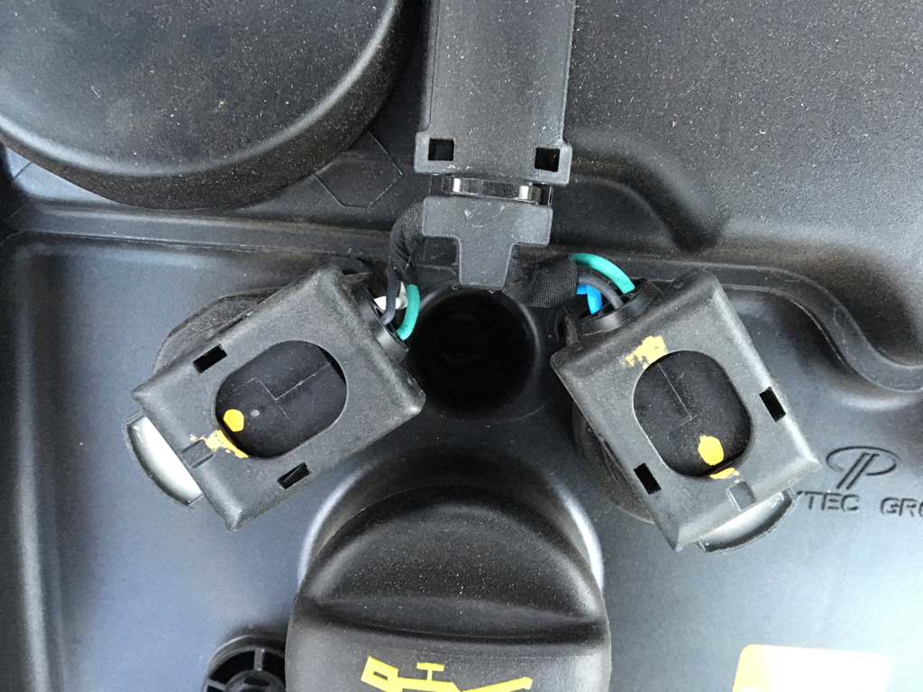

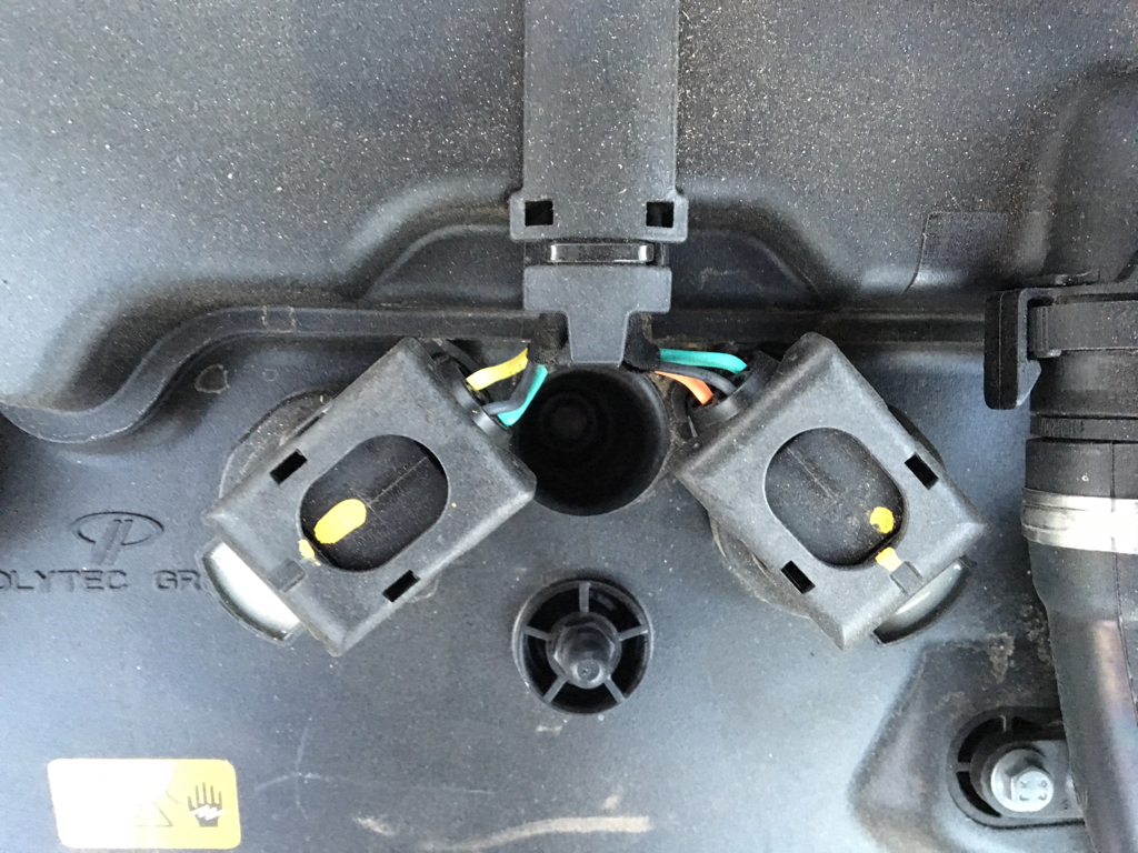

Basically what i am looking for is anyone with a N18 engine can let me know the wire colors for each coil pack.
Recently changed spark plugs and broke the guide that hold 3&4 wires in place and ended up possible changing the location of them so before i fire the car up i just want to make sure they ended up where they belong. Right now they are Cyl 1: white, Cyl 2: blue, Cyl 3: yellow, Cyl 4: orange.

Here you go, from my N18 motor mQubed Motorsport, Manic Tuning Dealer
Glad it worked out. The power of social media!
