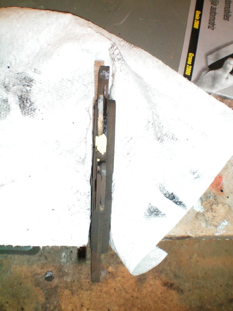

check 'em yourself
easy to do, for a quick check you don't even need to pull a wheel in many cases
you can look at the caliper and see the pad. The seat of the pants rule is when the pad material is thinner than the backing plate it is time to start thinking about new pads.
Here is an almost new front pad from a GEN2 MINI, I've put some white paint on the backing plate
Here's a worn pad ...
Also note that on the 'new' pad you can see the bevel on the edges of the pad. Note, that where the level of the material is about the thickness of the backing plate, the bevel is gone ... another seat of the pants guide.
