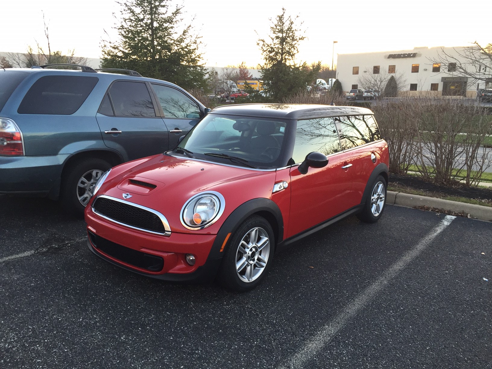

Hey Everybody! I just bought a 2011 Mini Cooper Clubman S last week. It is in great condition with 38,000 miles. I want to increase it's performance, but not sure where to start. I have looked at cold air intakes and a computer chip. What will give me the most performace bang for buck? If you all have any other suggestions on what I should do to customize, let me know! Thanks
