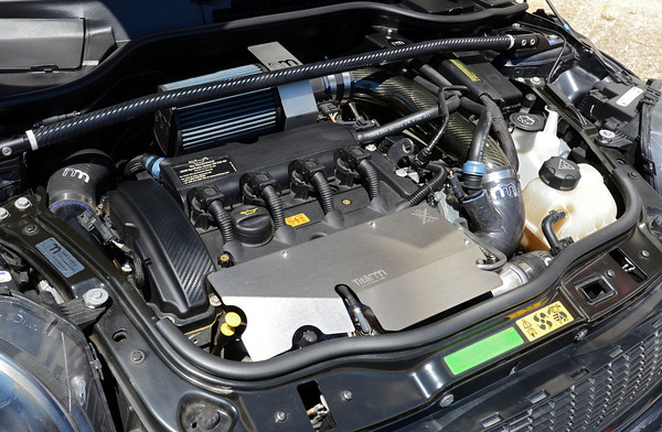

Here is what you need. The NM Engineering Titanium Heat Shield.
http://www.nm-eng.com/231/11/0/1455/...at-shield.html

I use the NM heat shield on my GP and recommend it the highest, plus it's more affordable than others.
http://waymotorworks.com/nm-titanium...011-newer.html

I have been using the NM heatshield on my 09 for over a year now and no issues. I have one on my wife's 2010 as well.
