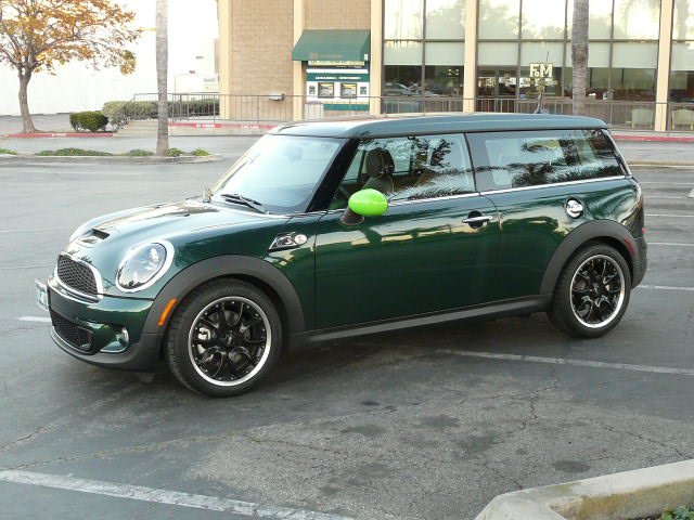

Just installed the set my dealer ordered for me, and they look great on a BRG2 car! BTW, the numbers quoted above are for the Non-Powerfold mirrors. The green caps are available for the power folding mirrors too:
Right: 51-16-2-162-746
Left: 51-16-2-162-747
Attached Thumbnails Mini Cooper Clubman s Mirror caps-p1150316.jpg   Mini Cooper Clubman s Mirror caps-p1150305.jpg
