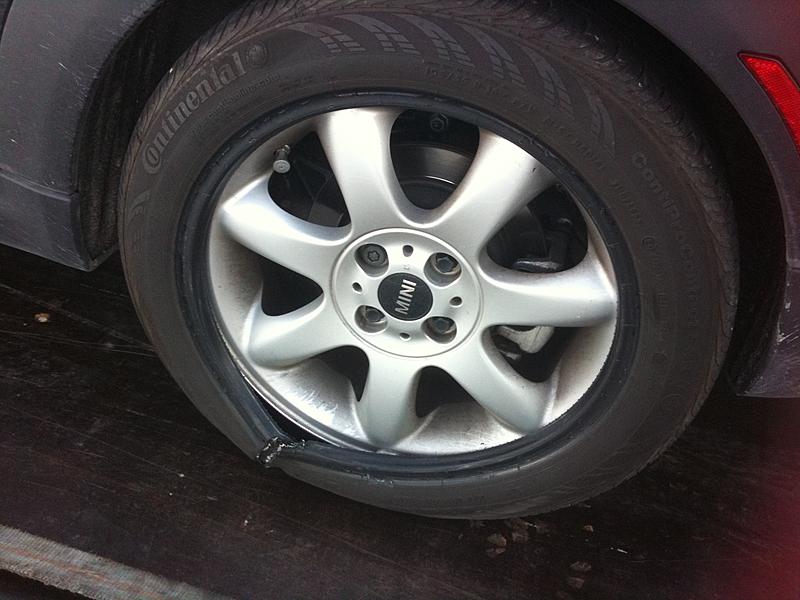

I was about to hit 30k miles and was buying new tires tomorrow after I did the maintenance at the dealer. However, on my way to work today, the sidewall on one tire blew out. Yes, it does sound like a gun. So I was stuck in the middle of nowhere on a rural highway.
Mini Roadside Assistance sent out a wrecker, but would only tow me to the nearest dealer instead of to a tire shop. So 70 miles later, I get to the dealer and they have no non-runflats and only one runflat for my car. What kind of a dealer doesn't have tires? I told the wrecker driver not to unload my car. He took me across the freeway to a Discount Tire store.
Now I'm the proud owner of four new 60k mile rated tires for less than the rf's would have cost. I called Morristown Mini from my dealer's showroom for a quote on a spare for my Clubman S shipped to me. Still a bit pricey, so I might shop around. Does it really cost $60 to mount the tire on the rim?
I was going to get rid of the RF's anyway, but having a blowout which prevented me from driving even to the nearest down sealed the deal.
