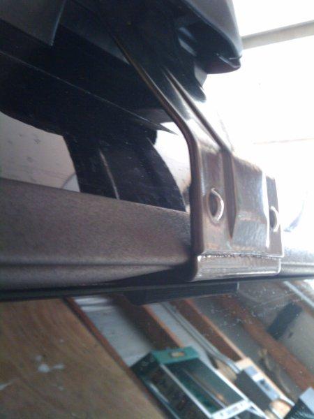

I am just getting my Clubman back today after driving, very slowly, under a low roof at an ATM. I had the Thule rack installed. It ripped the side molding completely off on the driver's side (the side where it pulls it up very high). It also creased my roof. The rack completely slid off with no damage to my bike. I am having an OEM rack installed. The Thule rack fit kit blows, in my opinion.
