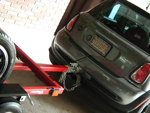

From: Montreal, Canada
I just bought this
http://www.kingtrail.ca/s_8.asp
With bikes on top of it, and my cargo box on the Clubby, we are set for camping trips
