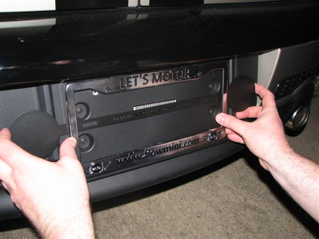

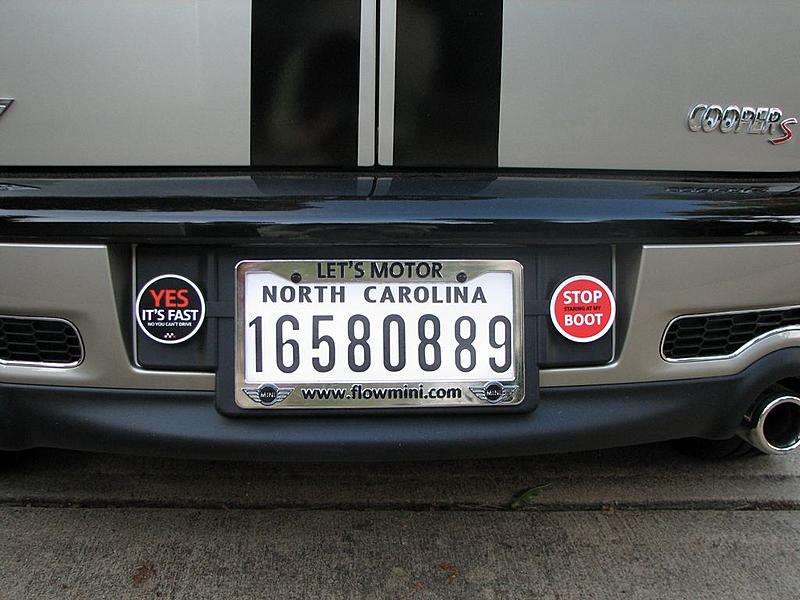

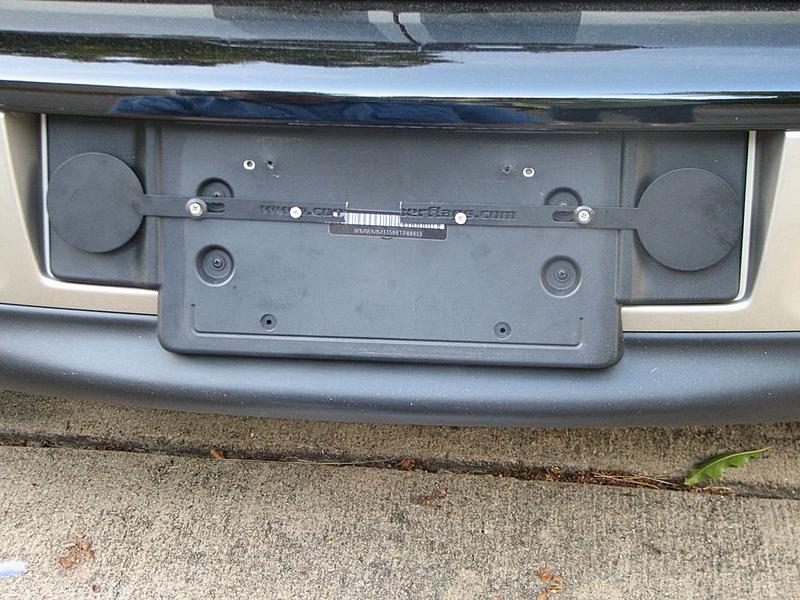

This is what I ended up doing. I went ahead and cut the bracket in half and filed the edges down. This allowed me to center the circles in the squares next to the plate. You can feel behind the bumper so no worries about screwing into anything. I figured a couple extra screw holes was no big deal since it is all behind the plate. So now I have essentially 2 badge holders, 2 screws in each. I think the pics show it all clearly. I didn't have to drill any holes, threaded my screws through the cooper flag letters. I've talked with someone at Cooper Flags and he is now aware and is working on a solution. I think he mentions on the website that it won't fit the Clubman. I think it looks really sharp on ours!
