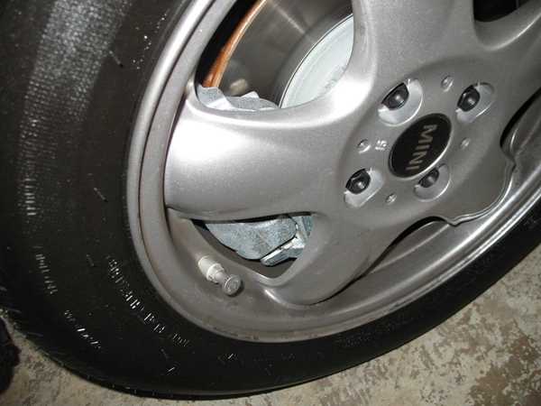

Valve Stem Caps- what is standard???
I picked up my Clubman last Monday. I noticed today that one of the valve stem 'caps' had fallen off. I walked around the car and examined the remaining 3 and I cannot tell if these are the final valve caps that should be installed for a delivered car or if someone dropped the ball at the VDC or the dealership. The remaining three caps were extremely loose and not that attractive. I am attaching a photo below of the caps that were on my car. On the top of the cap reads "TPM INSIDE! RESET TPM!"
BTW, I have the factory 15-inch wheels with the performance tires and I am in the USA.
Thanks,
Paul

Nope, those are the valve stem caps that come standard on all the MINIs I've seen. I think it's essentially to remind you (or whoever fills up your tires) to reset the tire pressure monitoring system when your tires are filled to the desired pressure.
I agree though, they are ugly. I will be replacing them when I get my new wheels.

Careful as you replace the missing one - there have been reports of dissimilar metal corrosion.

If you do a search on this forum you'll find references to metal-to-metal corrosion, as the valve stems are aluminum. Do not use any type of metal cap. MINI now makes plastic OEM caps with the same designs as their metal caps, if you want to get rid of those ugly silver mushroom things with writing all over them.

I can assure you the valve stem caps have nothing to do with the function of TPMS. They are simply there to remind the user to reset TPMS after filling the tires to the proper pressure.
It is true that metal caps could possibly corrode to the valve stems, and there is plenty of documentation all over this site of that happening. Might as well play it safe and get some good looking plastic ones. As mentioned, MINI is now selling plastic caps with the same designs to prevent corrosion.

You could, but I wouldn't if I were you. It's just not worth the risk of having to have your valve stems cut off and replaced. Just not worth it.

Steel is bad news on aluminum.

I don't think the issue of the steel cap seizing on the aluminum valve stem is as important as the steel cap interfering with the signal from the sensor in the wheel to the module in the car. They are plastic for a reason.

There is a receiver at each corner of the vehicle for the TPMS sensor as well as a central antenna.
The metal caps do interfere with the signal on some MINIs, but because the frequencies are all different, it may not be an issue on other ones.
Seeing as MINI offers the logo caps in plastic, there's really no reason not to use them instead of the metal ones.
