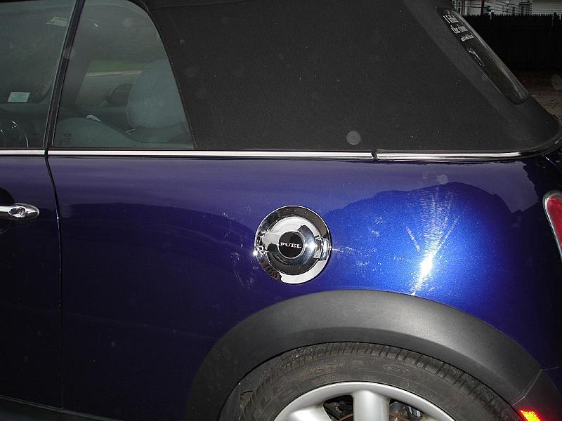

It is not a clearance issue, it has nothing to do with the top or the windows, theres a thread on here i staterd all about this, i was going to custom do one but the REAL reason is the hole is not big enough for the chrome set up. you would have to get a section from a hard top mini and cut yours out and weld the new piece in and thats to much work, so i did this:

The real reason you can't put the chrome gas cap on a convertible
Heres the real reason why you can't put a chrome gas set up on your convertible: What a waste of time and money now, the reason it dosn't fit, - NOT hitting the rear windows going down, NOT hitting the top going down, NOT the shape or position either, all myths, theres plenty of room IF the HOLE was bigger. The hole is not big enough and to do it right, better off finding a junk hard top, cutting a square around the gas opening, cutting your rag tops out and welding the other in and sanding and prepeing and repainting it, not for me to much work for now. oh well i guess i am the first to tell the truth about it, since all the answers i got were hitting something or not positioned right. hope this helps anyone that wanted to know.
So here it is, i got my chrome gas cap on my convertible, lol its now one of a kind, but its on and looks awesome a little custom work, some cutting, and taadaa!! took about 2 hours but it was worth it
Attached Thumbnails Why can't convertible S's have chrome caps?-chromegascapnew.jpg

Because nobody looked at the original post that was started and decided to say the same wrong information, i actually took the gas bucket out so i know theres room in there, just the hole is not big enough for the chrome style gas bucket. heres the original post:

Nice work Tim ! Looks awesome
