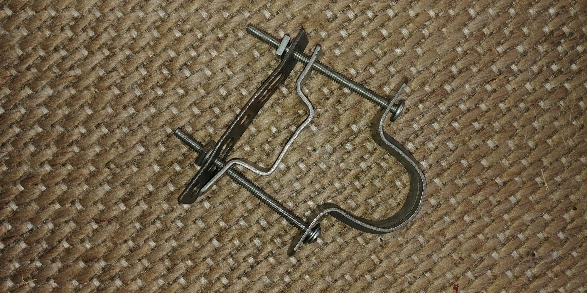

BigDog, it's imperative that you compress the slave cylinder while bleeding. You can fashion a tool to do it. Here's a picture of mine using a 1-1/4 inch conduit wall clamp, some scrap metal straps and a couple of long screws, washers and nuts.

NC TRACKRAT, I was able to fully compress the slave cylinder and bleed, but to no avail. Curious, if you see the picture below (example) the rubber part stayed inside the clutch and didn't come out... and there was a black powder that fell out with the rest of the push rod (internal to rubber part) . I still bled it, but I think the slave cylinder maybe shot... don't you think? I ordered another one today to be sure. Also, when I do pull the old slave cylinder including the rubber part noted below, will there be any fluid leakage when completely detached from clutch? Thanks in advance.

I believe BigDog says that the rubber boot on the slave cylinder collapsed and black dust fell out with the broken rod, not the master cylinder. It's a wonder that he can shift at all. Yes, when the slave cylinder is detached, you'll lose fluid and more bleeding is in order. If you keep the cap on the reservoir, it may slow the flow down some.
