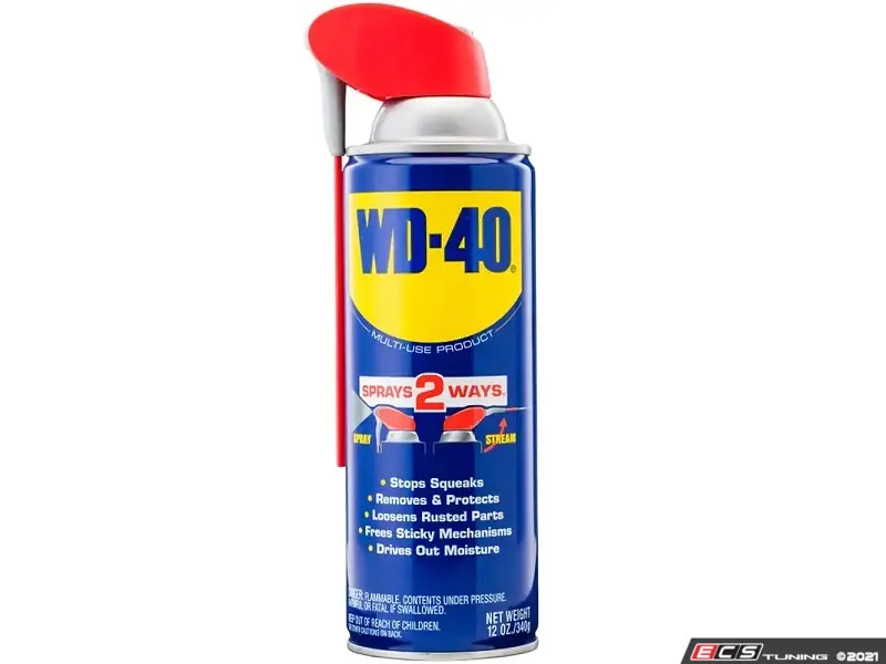

Just that one link above. Cables has bunch of DIY which are linked that's the only one of that section. BMW and MINI TIS (tech repair) you have to pay for now: https://www.newtis.info/tisv2/a/en/
Make sure you clean the rails where things slide when dismantled and re-grease with sunroof grease and WD40, WD40 helps clean out the gunk also with a cue tip
https://www.ecstuning.com/Search/Sit...h/83192157321/
https://www.ecstuning.com/b-wd_40-pa...-ways/49005kt/
