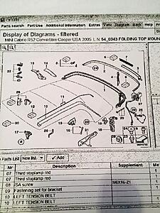

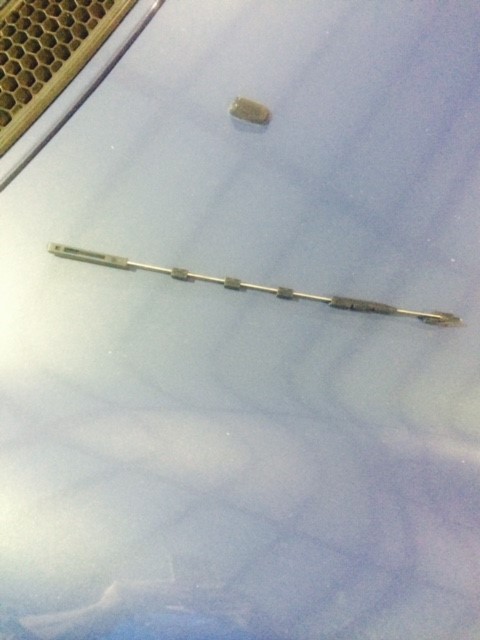

I have a 2005 Mini Cooper Convertible that will not release the passenger side latch when going from sunroof mode to stage 2. The mechanic took it apart and identified a broken part but is having a problem identifying what part this is and where to get a replacement.
Here is the broken part:

Here are the diagrams from the Mini dealership but can't figure out which part it is:
More part diagrams
Can anyone help me identify what part is shown in the first 2 pics and where to find a replacement?

I have the same problem on both sides i think it’s parts of the sunroof assembly it can’t be bought as a item have you got some luck in finding it
Old Feb 8, 2023 | 12:01 PM
Posts: 36,762
Likes: 2,551
Yep part of the cassette.
https://www.northamericanmotoring.co...tible-top.html
https://www.ecstuning.com/b-genuine-...h/54347180038/
Maybe some junk yards will that the top box cassette.
