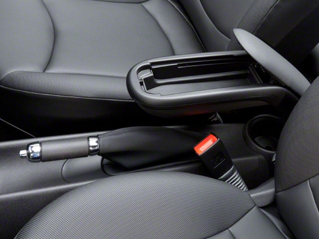

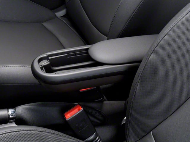

Originally Posted by deepgrey
There are still new euro R53 armrests floating around, too, or at least there were the last time I checked. That “R56 armrest” is just a slightly modified R53 euro armrest.
the R56 is completely different as per the picture below. The lid opens up with hinge on the rear of the lid....the first gen armrests have the top cushion slide to the rear of the car...and there's not much room inside for much of anything
Old Jan 12, 2022 | 01:50 PM
deepgrey's Avatar
deepgrey
Joined: Jun 2009
Posts: 1,318
Likes: 491
From: Atlanta, GA
Yeah, that's just a modified version of the old Euro armrest. I should know; I own one. IIRC, for a while it was the only OEM option available for the first gens before the integrated one with the sliding lid came out.
See the difference in the feet from the R56 version?
Supposedly you have to modify the R56 armrest to get the seat rails to sit right, but I've never checked since I have the R53 one.
Edit: After looking at mine, I don't immediately see what would require modification. Maybe I'm misremembering what I read years ago.
Last edited by deepgrey; Jan 12, 2022 at 02:24 PM. Reason: took at look at my armrest

Here's a close up of the R56 part. Now I see what people were talking about with the seat rails. The feet for the R56 armrest are thicker.
And the photo below is the one for the R53, which was introduced some time in 2004, IIRC.
