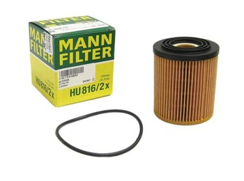

many of us will say use genuine MINI filters ONLY ..... in the early days there were many issues with other brands not fitting correctly. I usually stick with MINI but have had folks bring me MANN for use on their cars I work on, and have not had a problem with these

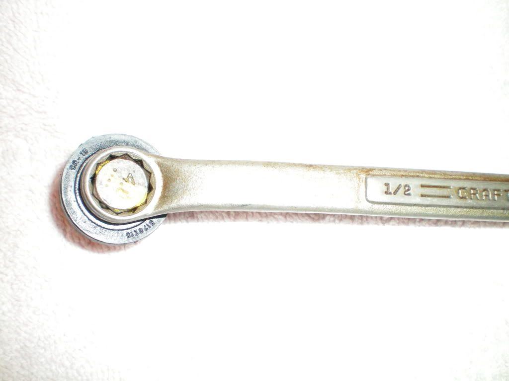

- most significantly read up about the drain plug being STUCK ..... you can find MANY threads on this topic. Here's a BIG hint .... the bung is a PERFECT 1/2 inch and NOT metric!!!!! Try it and you'll see! Many a bung has been rounded off by a poorly fit metric socket.

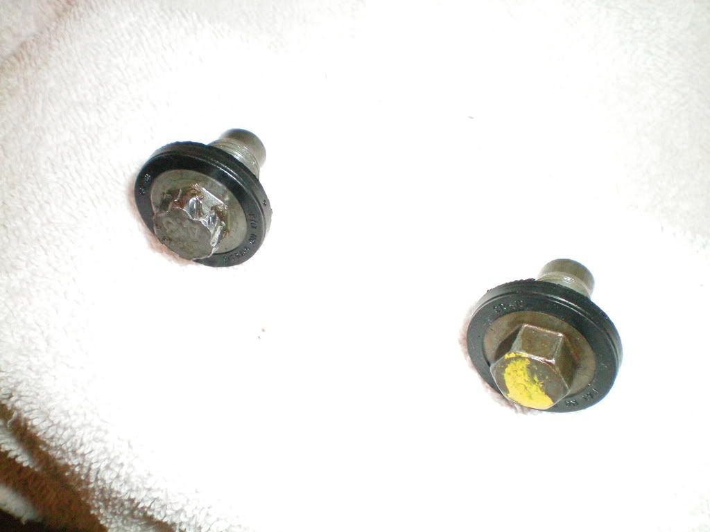

- the GEN1 plug is technically a ONE TIME USE item, with a built in plastic seal ..... you don't replace the seal, you replace the whole plug. I recommend switching to a Fumoto valve and forget about the entire stuck bung issue!
(left one mangled by a bad fit & a good one)

I use the Mann filter, Genuine oil in the past and now have Liqui Moly. 100% above the on filter and that drain plug size. Been changing mine since late 2004. Almost 300K now. I use the schwaben 36mm 6 point low profile socket .

I have only done one oil change, but I used Mobil 1 5W-30 with a MANN filter. From what I understand, MANN is the OEM for BMW/MINI, and is much cheaper because it lacks the roundel on the box. However, I may be wrong. Whatever you do, avoid Fram for reasons that are very well known. I would use Super Tech before I would use Fram!

MANN may make the OE filter but having them side by side on my bench it is clear the MANN boxed one and the MINI boxed one are not 'the same' ..... the MANN functions fine but they clearly are different in construction and appearance.
