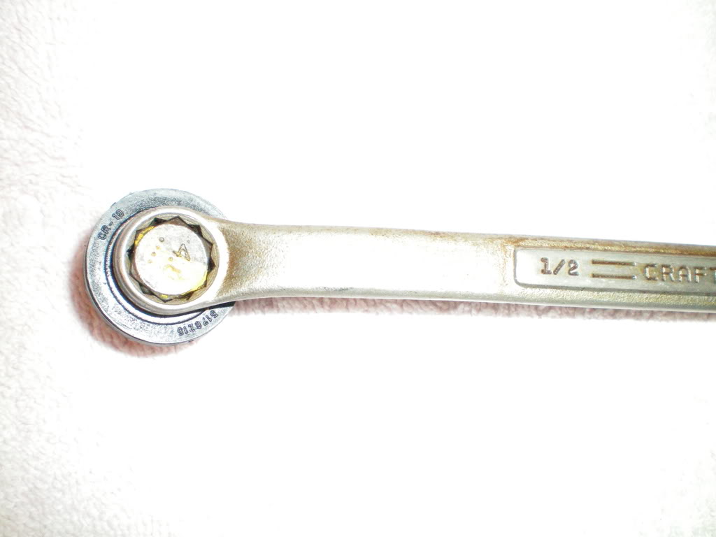

IMPORTANT!!!!!!!
The standard oil plug/bung is NOT the mm size they tell you to use . . .
it IS a PERFECT 1/2
here's a pic of a good bung and one mashed by the metric wrench after extraction
STRONG SUGGESTION ..... get a Fumoto Valve . . . qwikvalve
(search on oil change here and you'll discover why . . . )
the 36mm for the filter needs to be SHORT ... you run out of room fast.

Regards the drain plug, I've used a metric box end (forget size, probably 13mm) for perhaps 10 oil changes and never had the slightest problem. Perhaps 1/2" fits tighter, but I doubt it is an absolute must have. And the mangled drain plug shown so dramatically wasn't mangled like that from using a metric wrench.
