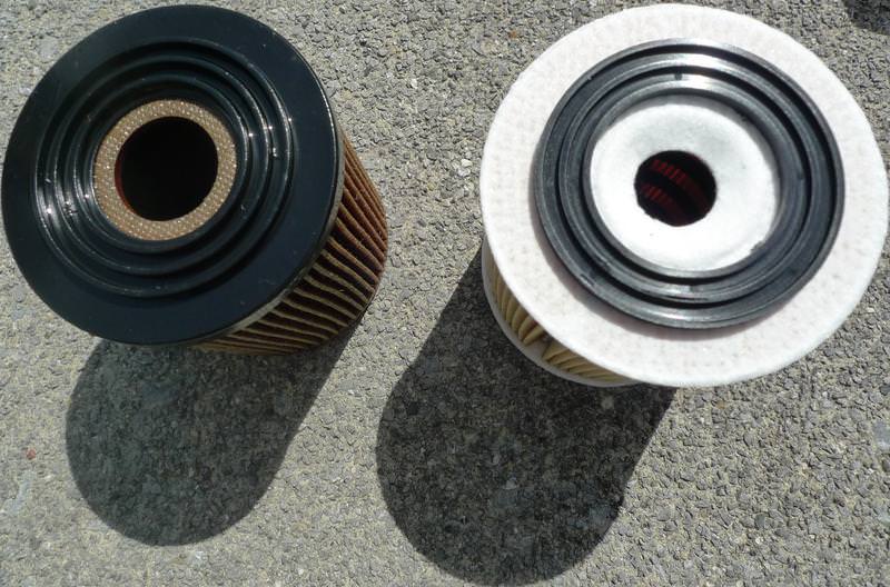

Just changed my oil for the first time and it was stunningly simple --- I expected possible problems due to reading around but now realize that most "problems" were associated with the earlier "cageless" filter design, but I was still somewhat worried I'd somehow manage to yuck up the bypass/drainback or something --- but no such worries, all is well it seems so far, light goes out and doesn't come back on, and I reset the interval warning from reading prior posts about the trip odo method --- still gonna inspect tomorrow just to make sure everything is hunky dory though...
...this was the first time I ever used a topsider excavator and man what a wonderful thing!
It made it all super super easy.
I chose a Mityvac 7400 and it worked the charm...
I used Royal Purple 5w-30 out of convenience because it was easily available, but in the future I'm leaning toward Amsoil.
I used an OE filter, but the previous owner used Mann.
The Mann, to my eye, actually looks like the better design:
