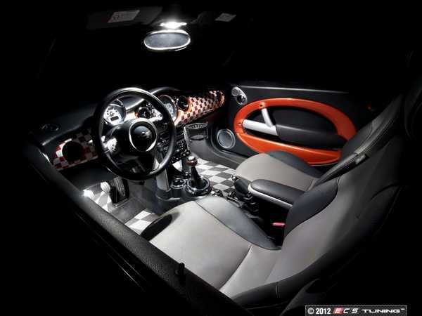

We use those Ziza bulbs with those resistors as they will not flicker or throw a code on the outside. On the inside some led bulbs flicker or just don't work with the voltage and LKM " light control module .
We have the Ziza kits here for the R52 and they look great and match in output.
Install pdf is linked on the main master kit.
