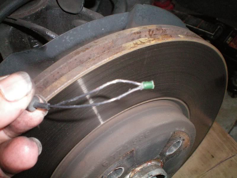

some of us believe the sensors are not needed cuz we know how to watch for wear
I just 'jumpered' the sensor. You can't just remove them because they work by creating an OPEN circuit .. breaking a wire in the sensor means the pad is done ...
so I cut off the used sensor end and soldered the wires together (remembering to insert some heat shrink tube for wx seal. Zip tie the wire out of the way and reset the sensor system. It sees a complete circuit and all is well. Just remember you are now resp' for watching your wear .. .

That's actually not bad idea Capt_bj! Not a bad idea at all!
I'm on the fence with purchasing these sensors, because this "is" my wife's car. And that little yellow light "helps" her to realize that she needs to drive with a little more care, until I can replace the pads. Otherwise - she'll think everything is fine until she starts "hearing" metal on metal, or the whole car jumps when she puts on the brakes! ;-)
I can easily keep a "check" on things, but as I mentioned, that little yellow light is a "help" in slowing her down until I can replace the pads.
Either way - it's a simple, and smart solution to spending "extra" money when you buy brake pads. (thumbs up)
